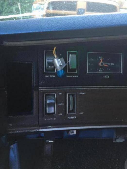

Here's the blue light I was talking about, under the filter there is a metal case around the bulb with only a small hole cut out, looks like it aims towards the column or steering wheel?
that just part of the dash lights, need to check it it has a power and a good ground. i highly suggest upgrading to quartz movement for the clock. i went thru plenty oem clocks just to find a good working one
