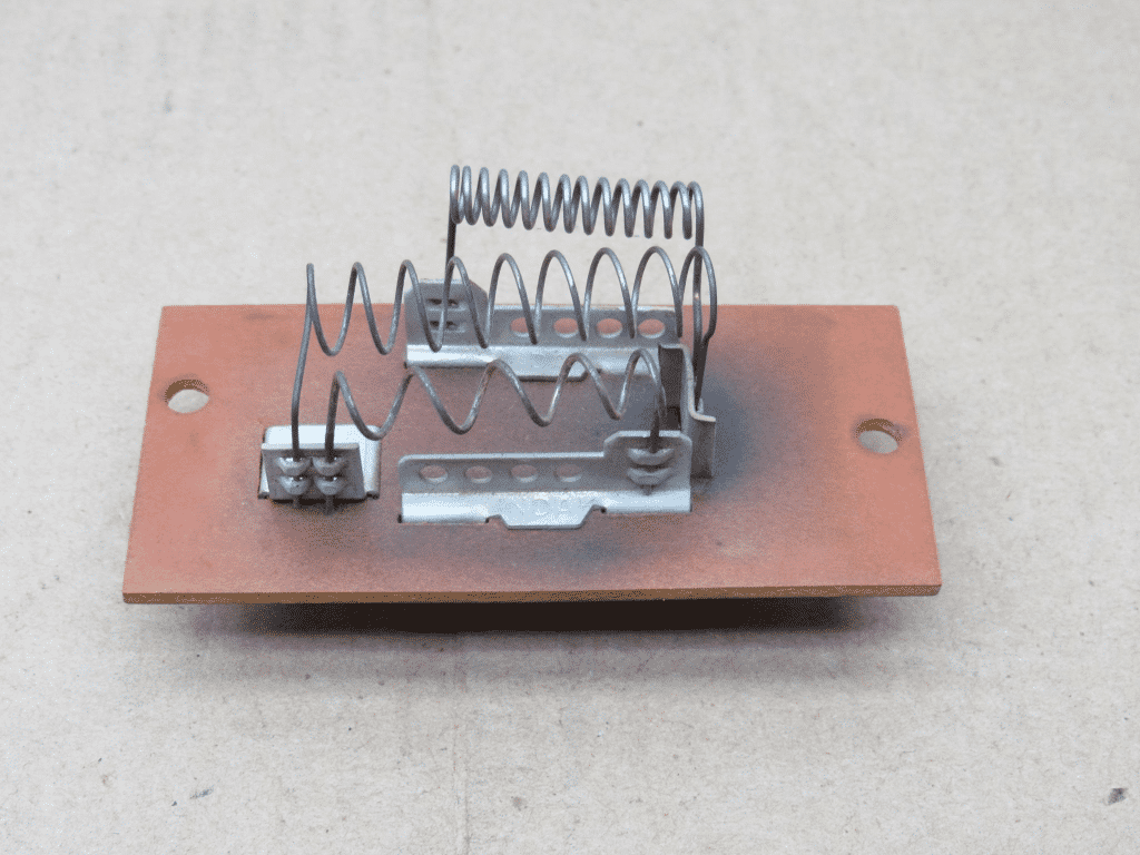

Your blower motor itself doesn't have multiple terminals, only one. The fan's speeds are controlled is actually at the blower motor resistor, which will be located somewhere on the actual heater/ac box. It takes the 3 circuits from the fan speed switch (low, medium, high) and runs each one through a specified resistance to reduce the voltage to the fan blower motor from low to medium to high.
It is designed to get hot, so the resistor assembly is usually found on the side of the heater box, where the resistor coils can be within the box to be cooled by the moving air.
It will look something like this:
The coils are the resistors - if they break, the speed for that particular coil won't work. High speed typically has no resistance on it, or the lowest. All those coils are sent to one wire that goes to the blower motor, on the firewall side, which means it goes back out to the engine bay through the bulkhead connector.
