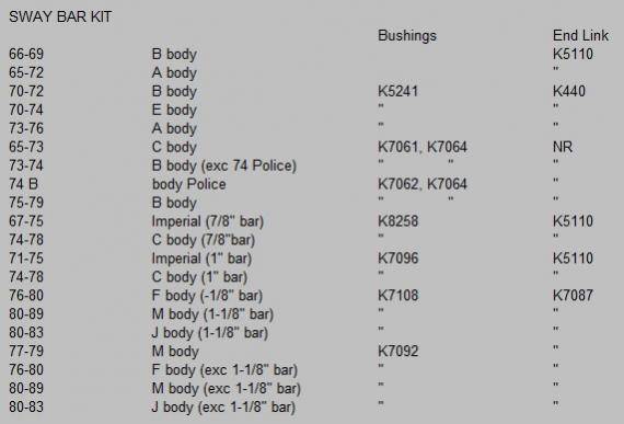

The bushings from RA are wrong. Look like they are for a Fiat. :BangHead:
I should have known. My fault. RA description say 3/" bars. Mine are 1".
The old ones had to be cut off so they're KAPUT.
Can't find P/N for the bushings in my parts manual. They don't even show it under SUSPENSIONS.
Mike, Bob, got a P/N for me??
Thanks.
Just ordered the correct 1" bushings Moog 7096 from Energy Suspension Parts.
THANK YOU!!!!
I'm dead in the water until these show up. You saved my butt.

Thanks anyway buddy. The above Moog part was what I ultimately was trying to find so it's a moot point now.
