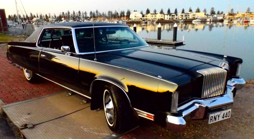

Pic of my Baby, down the local beach, getting a tan !!! lol
= 1 Owner / 50 Miles / Triple Black = yummmmo
