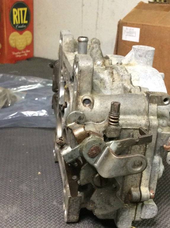

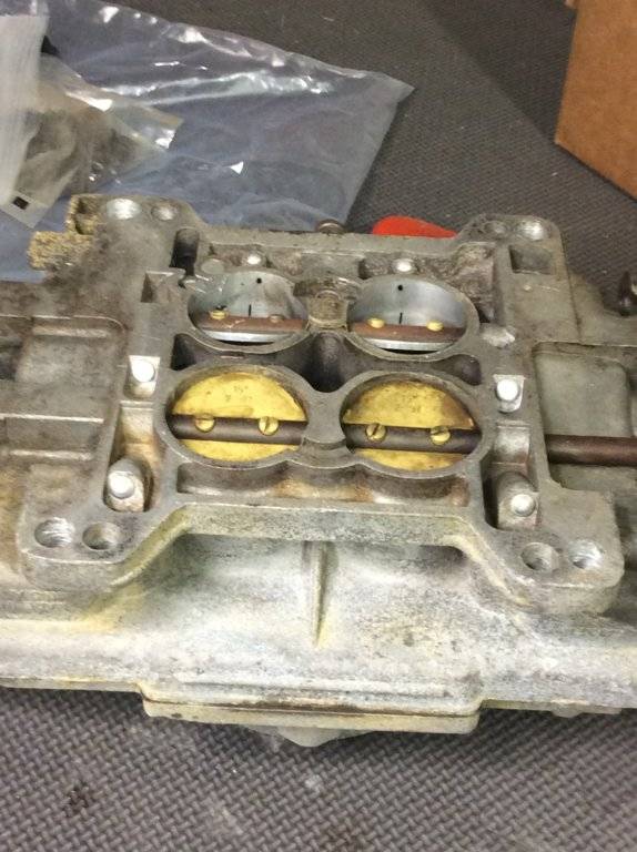

View attachment 177573 View attachment 177574
The fuel bowl on Carter AFB and AVS carburetors are a one piece casing. Passages are drilled for the fuel to get from the fuel bowl,plugs are installed after that. You can leak raw fuel into the intake manifold and on the outside of the intake. That is why I replaced the carburetor in the pictures. How I found out was after I ran the car and parked it I removed the carburetor and found raw fuel down in the intake. As far as hard starting after a warm soak, it has been an issue with our cars ever since I can remember. 1/3 throttle when starting a hot engine seems to work best. Remember we are driving 50 year old cars. :thumbsup:
Sounds like good way to check for fuel leaking into the intake.. When I take the carb off to adjust my divorced choke thermostat coil, and check out the passages and bowls, I will now certainly look for fuel in the intake. I'll just be sure to do it right after a drive.Thanks for the tip!

On carbs with the normal pot metal castings, when passages were drilled into the float bowl, they were sealed with a ball bearing and "sealing solder", then the outer area where the ball bearing "seal" was, was peened (or small flanges bent over the ball) to keep the ball in place.
This was common, back then, on Rochester carbs, for example.
With time and exposure to ethanol'd fuel blends (as E10), the ethanol would degrade/"eat" the solder until fuel leaks happened and the ball bearing would usually be found on the intake manifold. As the passage usually went to the float bowl, it emptied onto the intake manifold (cold or HOT). Hopefully, fuel would be smelled and the problem fixed, but in some cases, it happened with the engine running/car being driven, which meant "fire extinguisher time"!
A believe the AFB/AVS has some of these plugged passages, but not sure what the sealing medium is in the aluminum castings.
As good as it might be to use the original carb, there might be some cases it should be replaced with something newer. In which case, AFB for AFB, you might swap the existing venturi clusters, jets/metering rods, power piston springs, etc. into the new carb so that the original fuel calibrations would be maintained. IF the jets/rods look to be close-match, then "plug and play". Then you'll just need to wire the electric choke.
