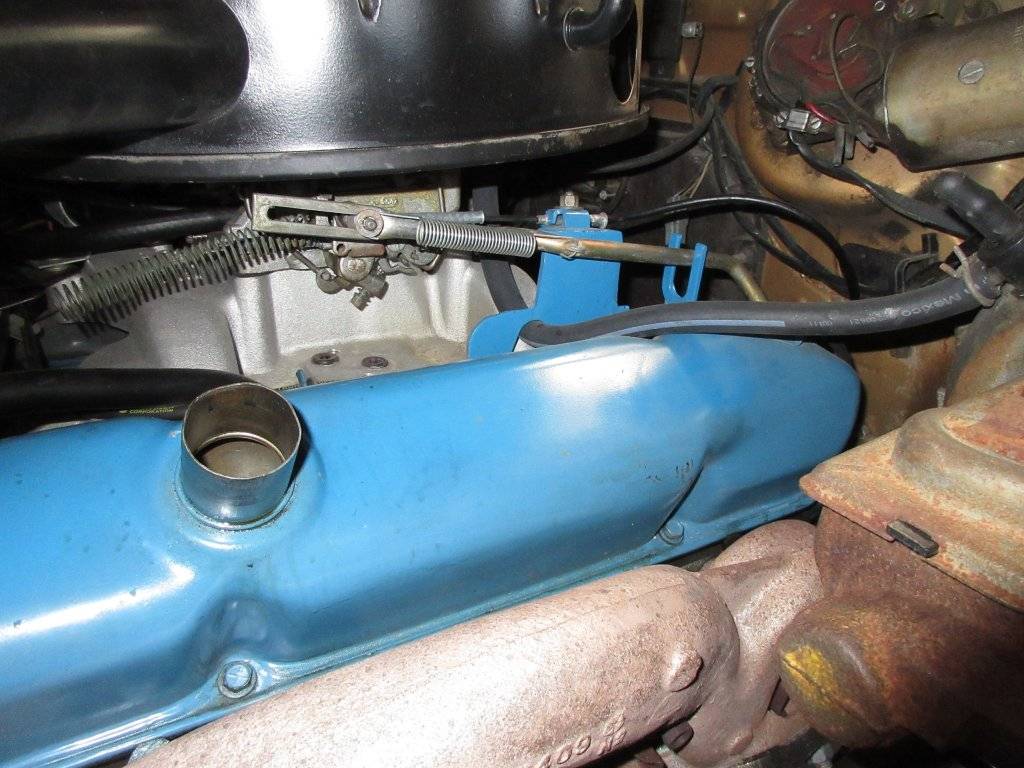

In regards to "pre-load and tight side",my 69 Chrysler has 1 rod that goes from the carb to the transmission.
For explanations sake, there is about 3.5" of movement on the carb from Idle to WOT. There is about 4.0" of movement on the transmission arm from full forward to full aft.
I have the rod pre-loaded by 0.5" so that at WOT the rod is all the way aft. (At idle the transmission is 0.5" off of the forward stop.)
If you "pre-load" any more, at WOT the trans arm will be all the way aft and the rod will either need to bend or the carb will not reach actual WOT.

What I am calling "pre-load" is past the OEM adjustment. On the '66 with the threaded rod, with the carb at hot base idle, the procedure is to adjust the slotted rod so it just touches the carb throttle stud, then lengthen the rod two more turns (i.e., pre-load, to me), and then reattach the return spring. Done. This pre-load was about 1/2 the diameter of the carb throttle stud, IIRC. My customized adjustment was to add two more full turns of pre-load to the linkage, to get the slightly higher shift points. Going more could well have meant the engine was past the power curve for the throttle input before it shifted, rather than grabbing the next gear and getting on down the road.
On my '70 Monaco 383 "N", it has the slotted rod and bolt. After getting used to id and how it did things, I just loosened the bolt and edged the rear rod rearwars a slight bit, then tightened the bolt. Same as we did on getting the '72 Newport part-throttle kickdown to work better.
I never did worry about the full travel of the kickdown rod, just that it had something left past carb WOT and was not hindering carb WOT.

There isn't part throttle kick down in 69. It has to be all the way to the floor. The Imperial was different.
Again, one rod. When trans arm is all the way aft there isn't any more aft to adjust too or pre-load. Having the arm all the way aft is why the transmission shifts where it does. If the arm wasn't adjusted to the aft stop at WOT the shifts would be sooner.
