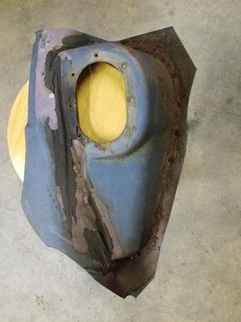

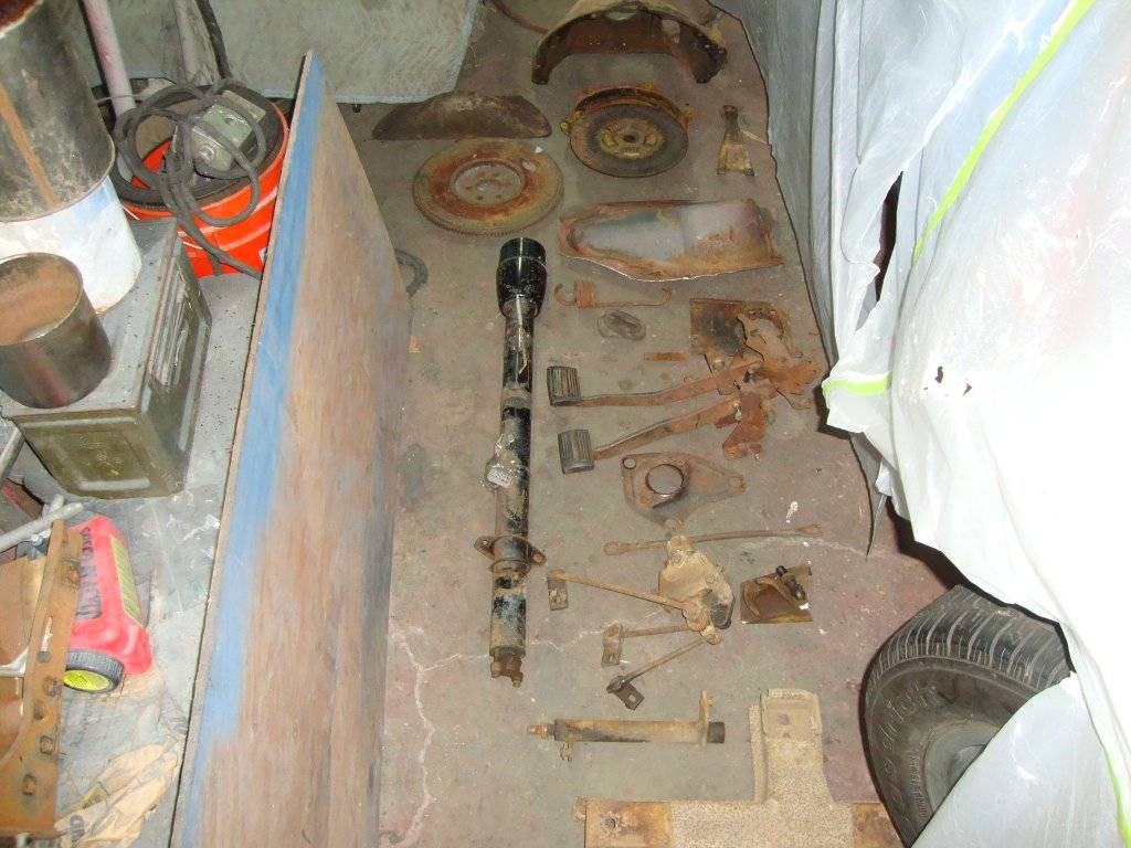

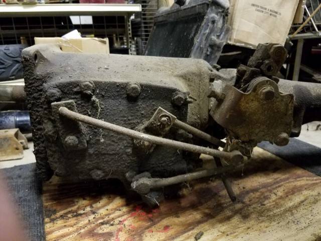

Fairly certain your bellhousing is a no go because the trans bolt pattern is different & they did not use the dual pattern in 1966 units. Existing clutch/ pressure plate should be good. The aftermarket Hurst Comp Plus for B bodies would work fine. Driveshaft should probably be OK. Floor plate that looks respectable will be a challenge to source or fabricate. Z-bar & hardware may be OK but may need some work. Personally I'd leave the 3-speed but to each his own.
