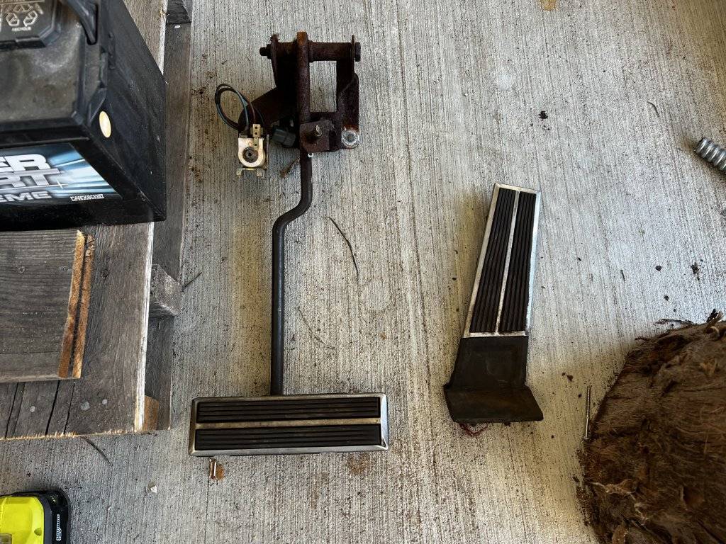

With the interior nearly gutted completely, I had the dashboard, steering column and pedals in my way. The thing about this car is, although it was a Cali car it’s whole life - the rats living in it caused some major rust damage. When they got up underneath the dash and made nests and were peeing and making a mess, the car got humid inside and that acid from their waste caused some gross rust. This caused a lot of hidden bolts underneath the dash to be rust welded / fused together. When trying to remove the brake booster, I had the time of my life reaching behind the dash and trying to break free the four screws holding it on. I had to get creative! Luckily, I was able to get it done.
The bolt sticking out of that stud attached to the bellow was absolutely frozen. I even tried hammering it out with zero luck. I do plan on selling this, as I am not using the factory drum setup. Whoever gets this and has it rebuilt will have to figure out how to remove that bolt :lol:. It was so bad that even when the brake pedal was attached, it didn’t move AT ALL.
I am not a small person by any means. 6’2”, 230 lbs - when I had the drivers seat in the car, I could literally push my entire weight onto the pedal and it just didn’t move at all, not even 1 cm. Crazy how much damage such small animals can do!

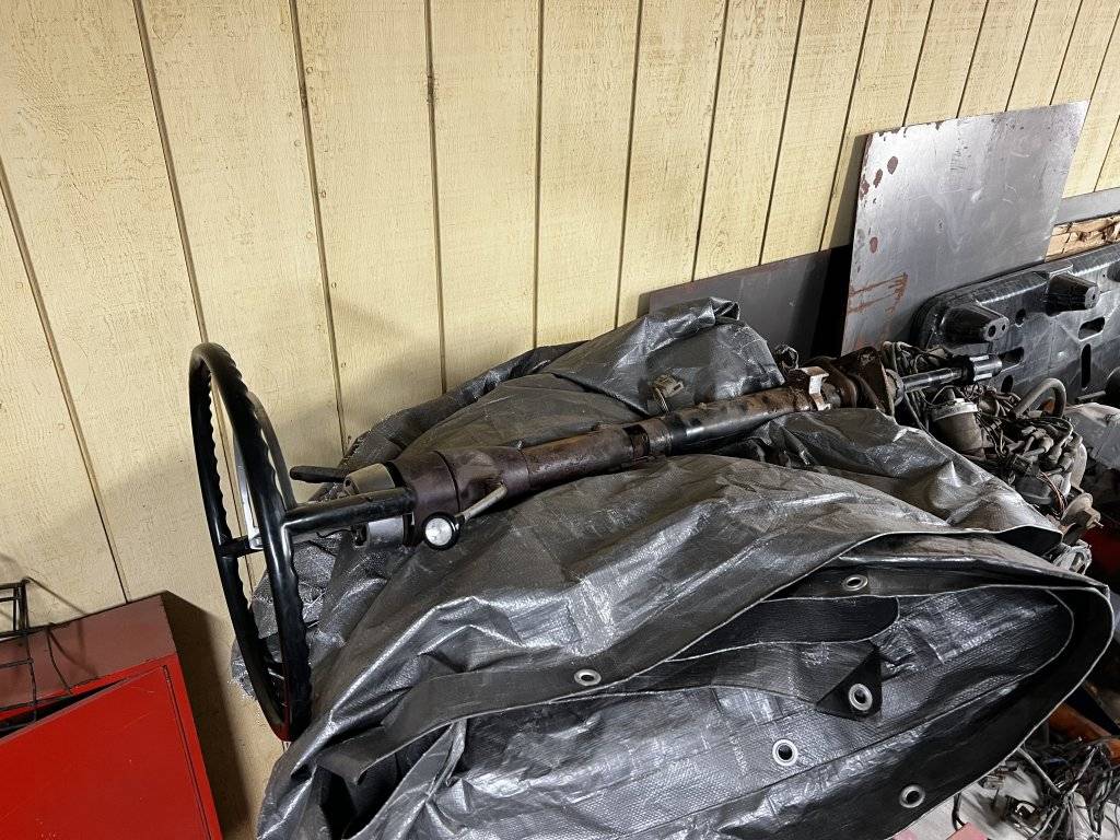

Next task, get the steering column out. Was actually way easier than I anticipated. Job took 10 minutes to do
She’s looking pretty empty about now

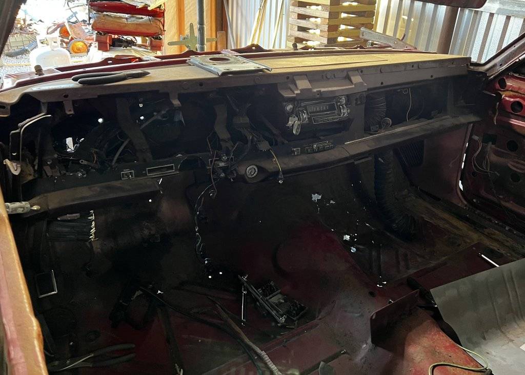

Now the task: get the dashboard out! It amazes me at how few screws are holding it up. I thought there’d be more!
Came out with a little effort, hardest part was removing the vacuum lines from the back of the heater control switch. Those were on TIGHT.
Now it’s REAL empty in here! Today I’m going to try and remove the heater box. I’ve been told it’s a few screws on the firewall side. If I can get that out, then I can begin bodywork on the firewall and smooth it out. I will replace the ugly sheet metal screws with nice stainless ones and cap them off with little chrome bullets or something. I want the engine compartment to be nice and tidy!

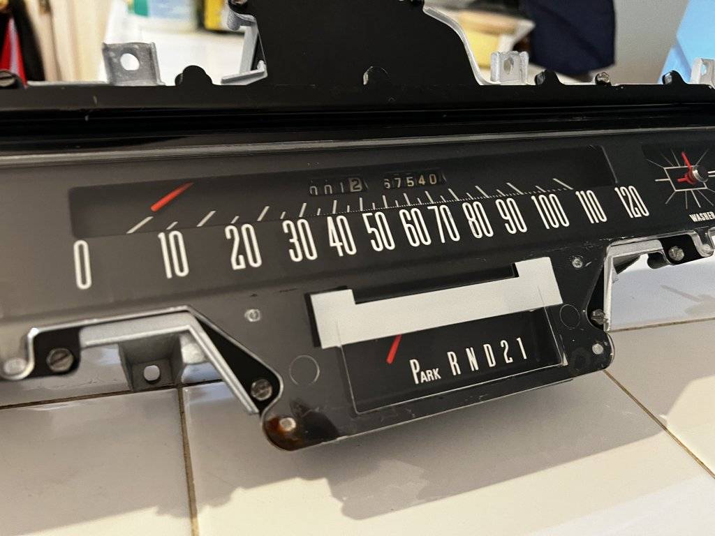

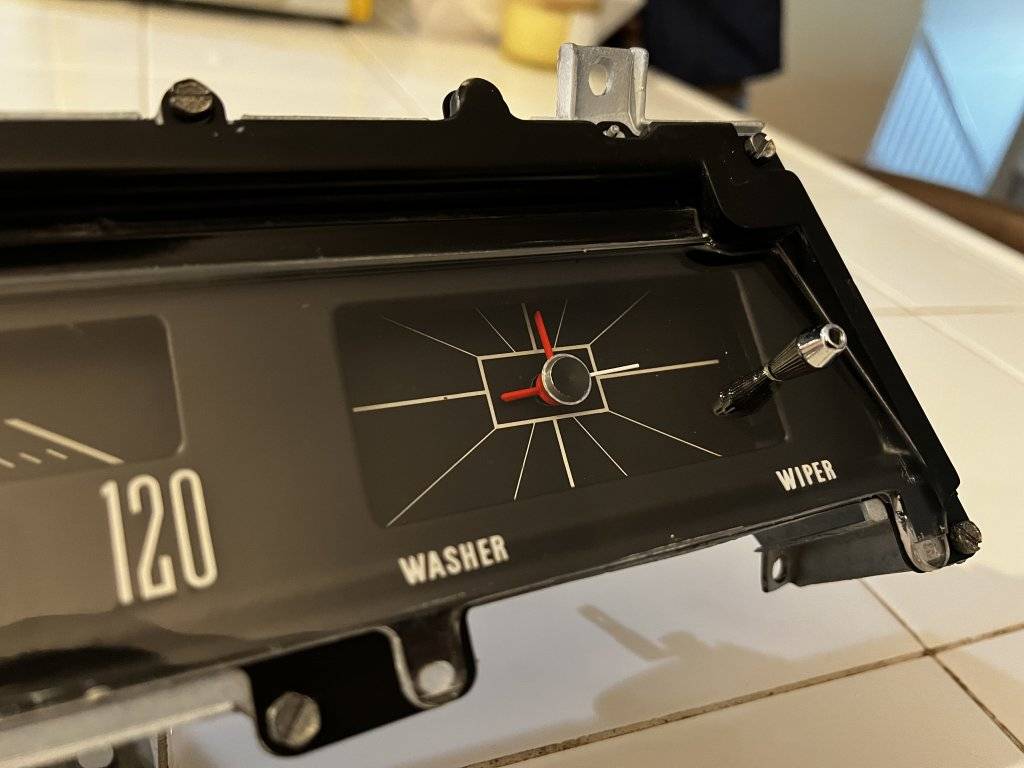

Really excited to have the rebuilt cluster inside. The ammeter has been converted to a voltmeter now, all other gauges have been rebuilt and calibrated. Clock has been converted to a quartz mechanism. Gonna look awesome to see it working and functioning as it should!

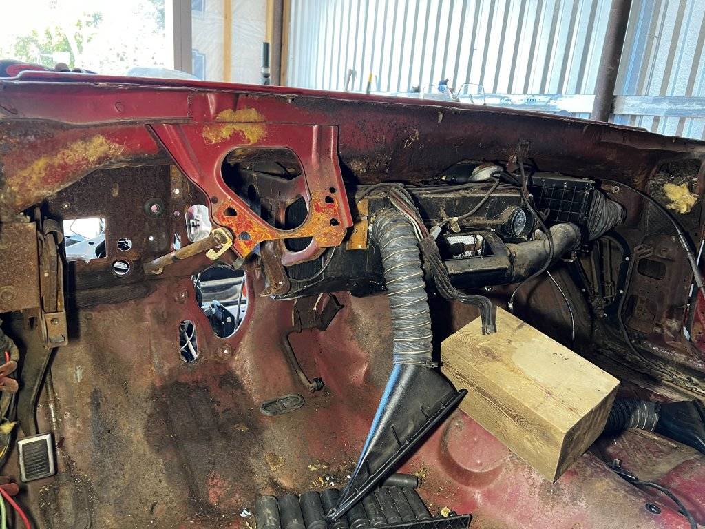

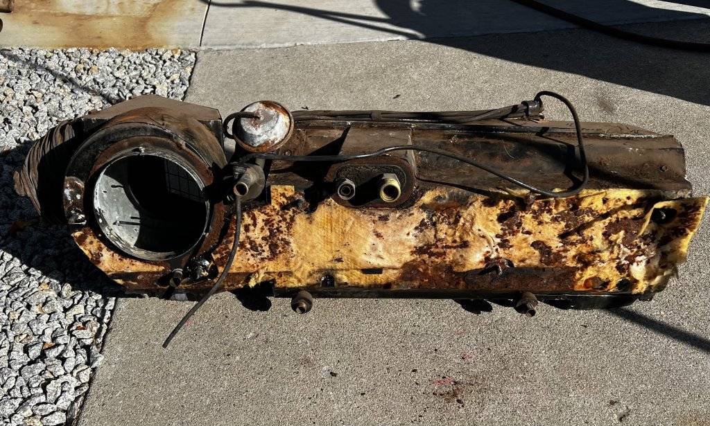

Today was another day full of good progress. Finally got the heater box out!
Full of rat droppings …
This thing is absolutely trashed! I have a rebuild kit on the way from DMT, I’m hoping it shouldn’t be too hard. Snagged a new AC/Heater core for the car.
Purchased it new on evilbay
Need to figure out the evaporator next. It’s been exposed to the elements and is likely toast… I do need help locating some components if anyone can help! The vacuum diaphragms or whatever they’re called.. I’m going to need them new. I circled it… pardon my lack of knowledge on the proper name.
Inside is lookin EMPTY. Firewall is clear of any obstructions now. Time to weld up unused holes and patch rusty metal. Then to body work it. Prime, sand and then paint! Once it’s painted and the heater box is back inside along with the dash, we can drop the 440 back inside. I look forward to that very eagerly!!
