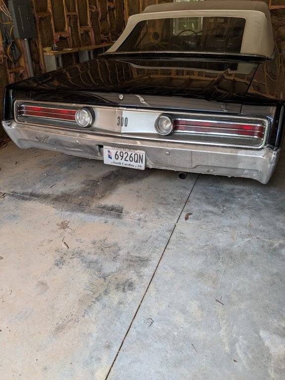

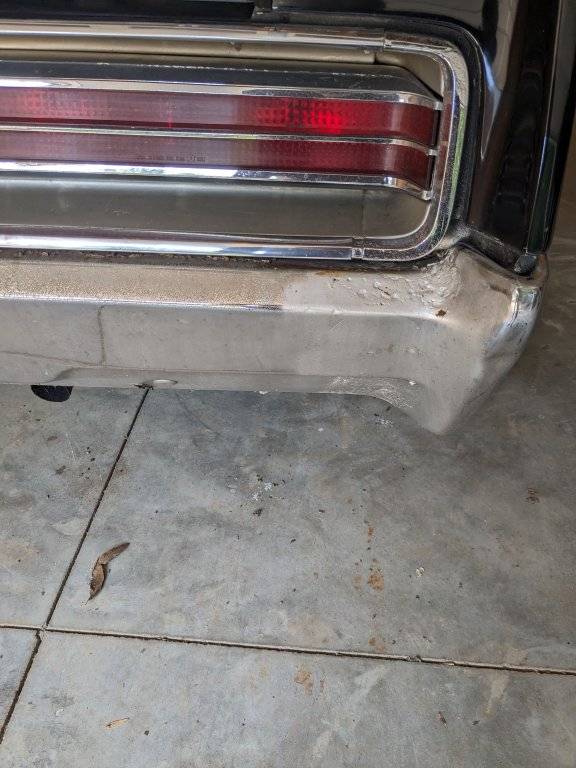

Cosmetically, the biggest issue is some of the chrome trim is pitted and the rear bumper is.. well, look at the pic. :(
Would it be easier / cheaper to find a replacement bumper or get this one stripped and rechromed?

Look for a good, used core bumper that can be shined-up nicely. Re-man unit would be a 3rd choice, all things considered. On the re-mans, look at the back side to see how many pic marks are on them, to see what they did to "straighten" it. THEN sight down the outer surfaces looking for waves and such. Some are better than others.

As for your bumper, the photo only shows a small section, is it rusted through, very dented? Does it just need plating? If you plan to replace it, for your search, the 1968
Chrysler 300, New Yorker and Newport all used the same
rear bumper. I doubt you will find a perfect bumper from a parts car, but you may get lucky. There are still some platers out there, Tri City Plating from Tennessee goes to Spring, Fall and Chrysler Nationals, all at Carlisle. I have seen Paul’s and Librandi’s, both from Pa, at the Corvette Nationals at Carlisle.

tri city quoted me 800-1000 to redo my fury so chrome isnt cheap at the moment

for a follow up...dropped my bumpers off at Tri City on 9/14 when i went up there for the Bristol Nascar race...think they called back on the 27th to say they were done...picked them up yesterday...I think that's a world record for chrome shop turnaround...they were 2 grand though...
