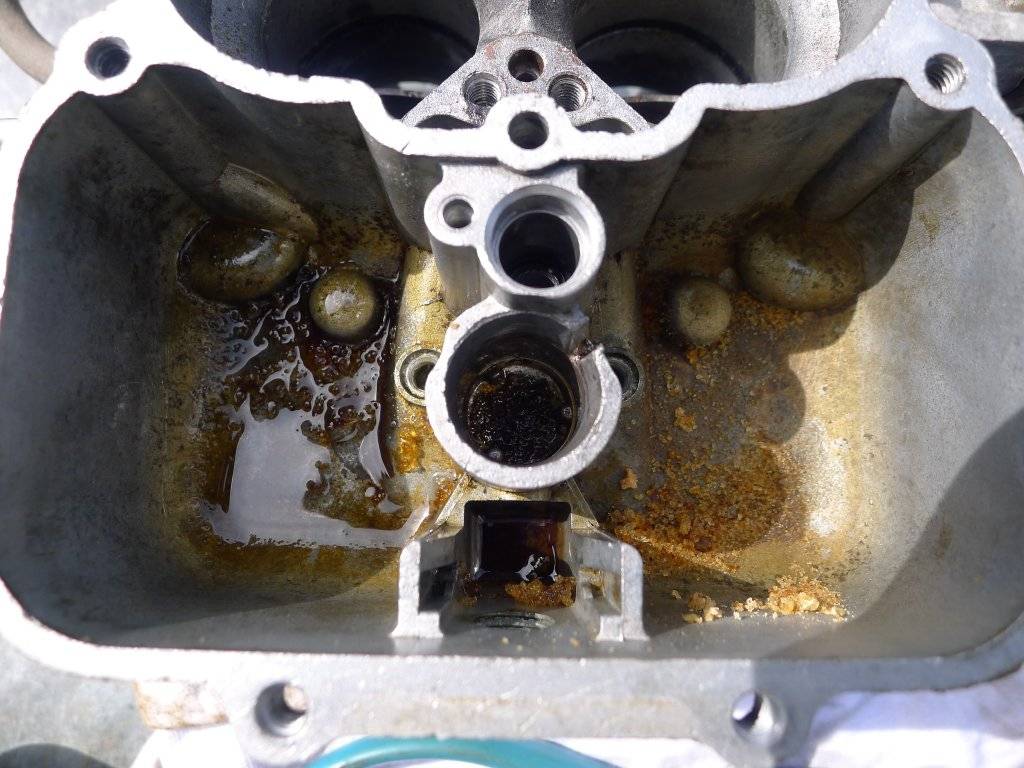

I rebuilt the BBD on my '70 383 back in 2013 - I always date kits and keep them on the shelf - and as we were leaving the yard one day to go get wood, truck barely made it across the road going towards the woods, and died.
I thought out of gas so went and got a can, but no can do.
So I had no choice but to pull the top off the carb at the neighbors, and found a whole bunch of brown gunk in there, and concluded it was from the gas evaporating and leaving crud behind, no other logical explanation.
I only put non ethanol premium in any of these farm rigs now, and they start every time, some sitting for 6 months at a time waiting for action.
This is what was in the carb, you can see why it might not run right like that.

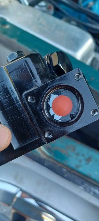

Been messing with the car all afternoon. Front float wasn't set right. Fixed it but one of the bolts that holds it in snapped off. However I can still secure the float. These FST carbs are painted black. And you can see in the photo that the gasoline eats the black paint, which then subsequently goes through the entire carb.
As far as I am concerned... these carbs are junk. They are a budget QFT carb but the paint on them just ruins the entire carb. I realize now that paint was the gunk I found in the carb.
Do yourself a favor, don't buy one of these. Stuck on the side of the road again after going out for a test drive
I think you've found your problem. Unbelievable that they sell carbs like that....
I think what happens is when cars (or farm equipment) sits around, the gas collects moisture and once it evaporates, that can be the crap left in your carb.
Back when we used dry gas in the winter, the ethanol (or methanol in the cheaper stuff) absorbs moisture and passes it through the engine to burn. Great for occasional use.... Now the stuff we buy is similar to the old gas, except being laced with so much ethanol, it's going to absorb and hold water... And that comes from the pumps at the corner station, moisture from high humidity and/or condensation collecting.
Not much to do except run no ethanol... or remove the ethanol from the gas. If you've ever watched any of the videos on how to do that, it's just dumping water in the gas, waiting for it to mix with the ethanol and separate and the pouring off the water/ethanol mix.
But, there's a lot of guys that do run the ethanol gas with no issues... Most likely they are using the cars more so everything gets pushed through faster. It's been my observation that the cars that sit are the ones having the most problems. Myself, I buy the ethanol free gas.... One of the things about living in the Finger Lakes area is all the boats around and as you get nearer one of the lakes, the more stations have the ethanol free gas. I can think of 3 stations within a few miles of home.
