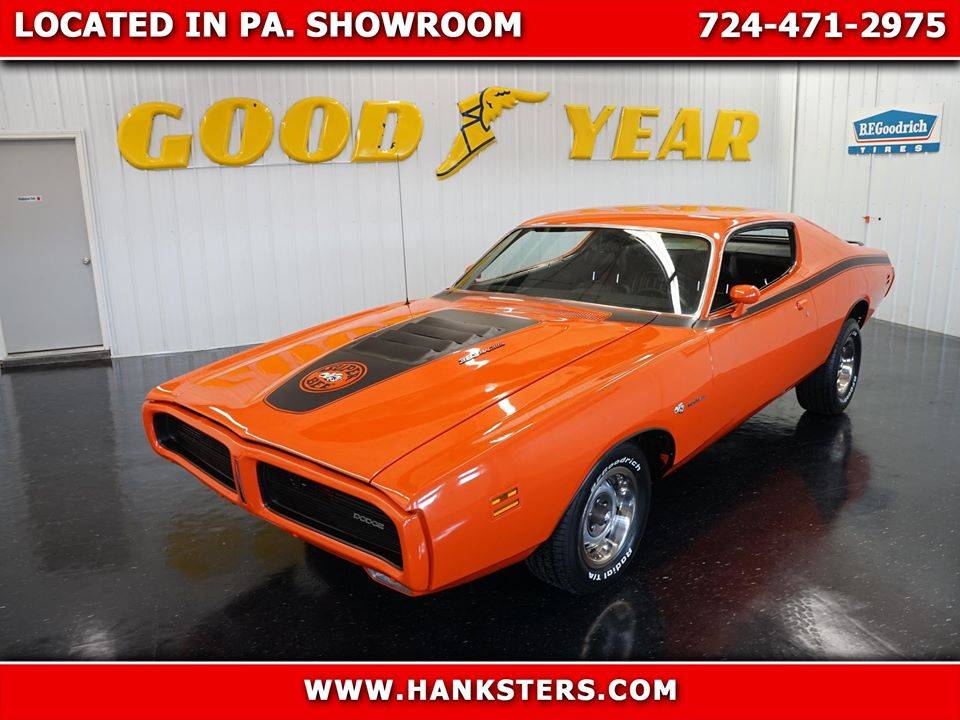

For Sale Alert! Rare Car w/PCV Valve-Not Mine????
OK Let's try it again...
But on the plus side it comes with the rare PCV valve, temperature gauge and fuel gauge.....

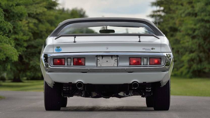

The car should have the dips in the rear Valance for Dual exhaust. And the tail lights should be Silver, not black.
lots of pics of on their site. Would a California car have had turn downs and standard valance?
I am not a full expert on these. But i would guess with a HP model it should. R/T or Superbee. Who knows how many cobbled pieces that car has from other cars. For the prices these people ask, i would want as many original pieces as possible. I did not look on their website. My bad.
Clone?
First turn off is the cheap *** steering wheel and buckets.
Second body tag missing.
And it got you a red X!:lol:
a Cali car would have had turn down tips and regular rear valance.
i think WM denotes a super bee.
for a super bee high back buckets were an option, so were the hidden headlights.
and the grille and rear tailight panel shouldnt be black.......
not a fan of painting the bumpers to look like elastomeric ones, not seen any that the paint lasts
Used 1971 Dodge Charger Super Bee for Sale in Indiana PA 15701 Hanksters
Yep. WM = a Super Bee
Originally a bench seat & column shift car.
The chrome exhaust tip were optional on low & med trim cars.
Pretty car but too much free-lancing done to get $35k imo.
Edit -- After looking at www.hamtramck-historical.com.
Concealed headlights were optional on R/T and SB, in the black grilles as pictured. That package also comes with the inside hood release, which was only available on the S.E. (std concealed headlights) or the R/T and SB with the concealed headlight option.
Body color bumpers could not be paired with the concealed headlight package.
Woodgrain on the dash pad was standard on the SB that model year. Chrome exhaust tips were optional on the R/T, so probably likewise on the SB
For the apparent time and money spent on that car, it could have been a very nice OEM-spec car, worth even more money, probably.
A nice car for what it is, from the looks of it. Will look good on the weekend cruise circuit, if that matters.
Just some thoughts,
CBODY67
Here's a breakdown of the convoluted run-on FaceFreaks marketplace AD.
(notice the big red flag) never heard of a 3.40 gear ratio either.
