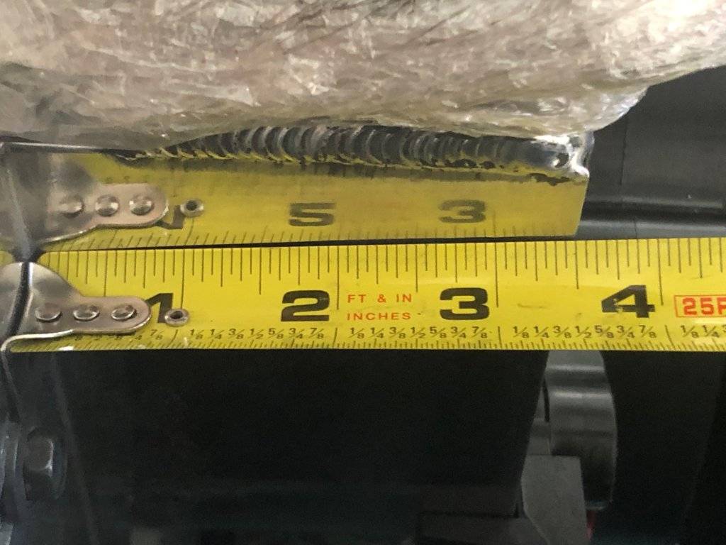

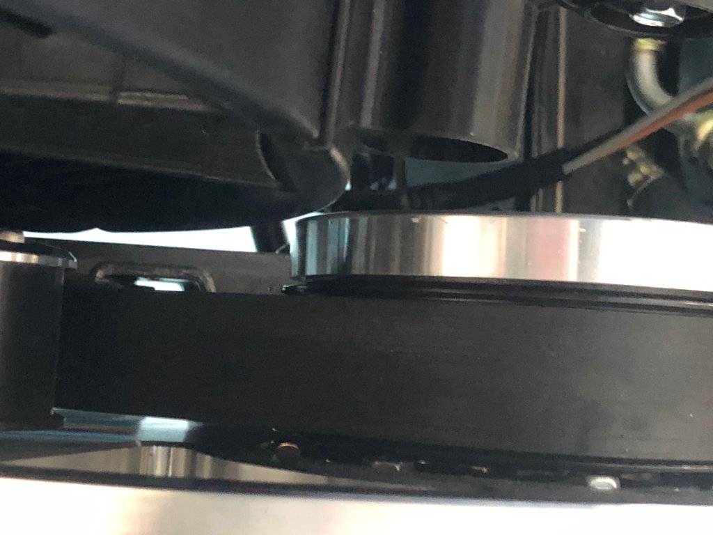

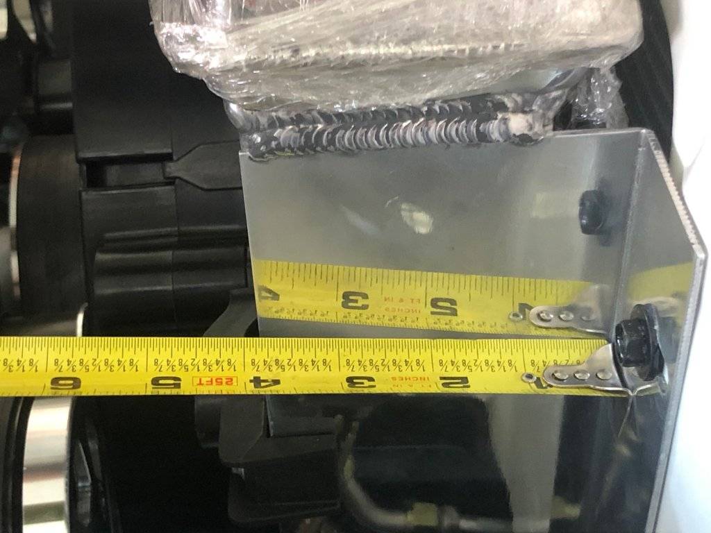

Upon installation, there was only a 1/16” tolerance between the Radiator/Electric Fans and the Serpentine Pulleys; obviously not acceptable. It was at this time that it was discovered that the Radiator Brackets were different between the sides of the Radiator with the Right Side being 4”’s, unacceptable, and the Left Side being 3 ½”, acceptable.

Question: Can the weld on the bracket for the radiator be taken off and replaced and if so, how is it removed and and re-welded/attached!

Suggestion, post some pictures
Most probable, bracket cant be removed and another bracket can be TIG welded back on

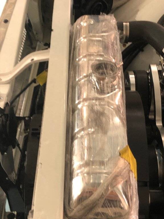

I'm curious, it looks like the radiator is as close to the support as possible. How much space is the belt/pully/fan system taking up?
The belt/pulley/fan system is not the issue if the right bracket was 3 1/2" like it is suppose to be and as it is on the original radiator.
The plastic wrap makes it hard to see, but it looks like it's nice and close on the driver side, and there's a gap on the passenger side. I can't imagine why that would be as most (all that I've seen) rad supports, are flat across the hole.
This makes me wonder if it's a manufacturing defect. In this case both brackets should be 3 1/2", other models use 4"? One bracket got mixed in with the others, and the welder didn't notice?
Whatever the case, it won't be hard to fix, for a good welder. It does stink to find out, and have to go through though. The welding job will likely be less than polishing another tank.

I think what he's saying is, the gap between the tank and radiator support looks the same from left to right.
