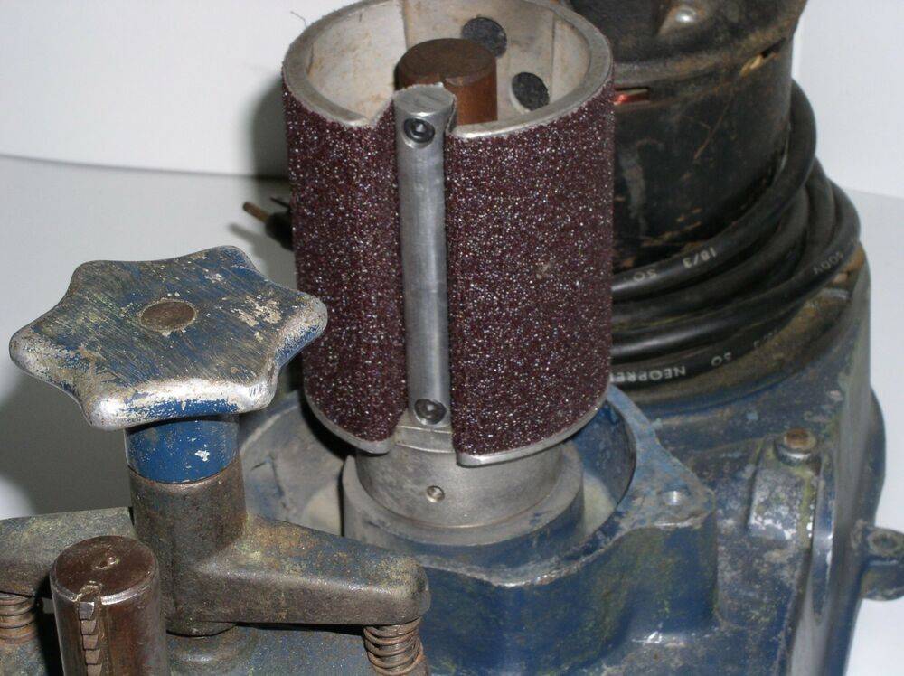

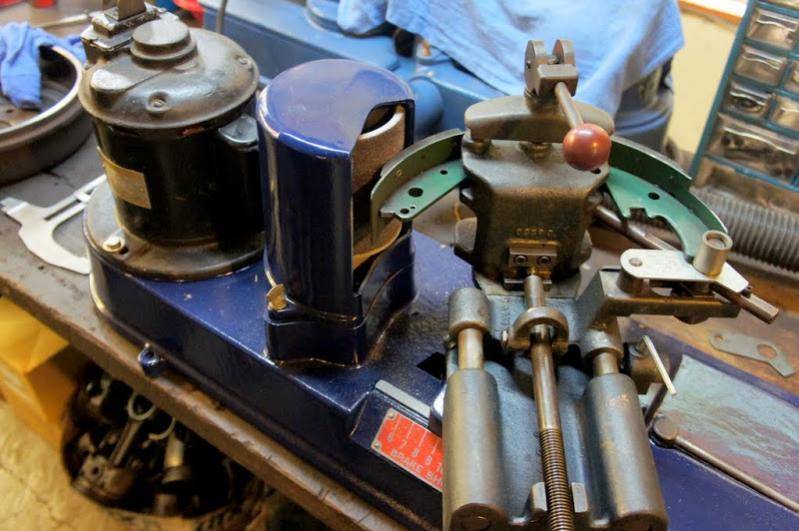

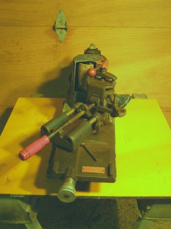

    Correct! there is/used to be a machine that would sand the friction material, goes back to the 20's/30's if memory serves. I remember watching that show "The Guild"? where they were seriously hung up on a set of linings that were binding on some pre-war antique, so much so that they were contacting the supplier to get the 'Correct' shoes. Of course this was the final leg of some restoration that was years past it's due date so to say (aren't they all?).
    None of them restoration experts in the shop had a clue about this old shoe sanding machine.
    I kept thinking FFS get out a belt sander and with the right touch your good to go and it's out the door!
    (edit) quick search to please the pic-whores!
    The abrasive: sanding vs grinding (not really a grinder IMO)
