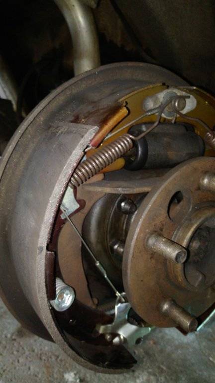

    I'm not entirely sure that it can be reversed but I'll look closely tonight. I will pull a few components out tonight to see if I can determine where it is binding. It's the same for both sides so e-brake makes the most sense.
    Can little changes like direction or order of springs on anchor make a difference?
