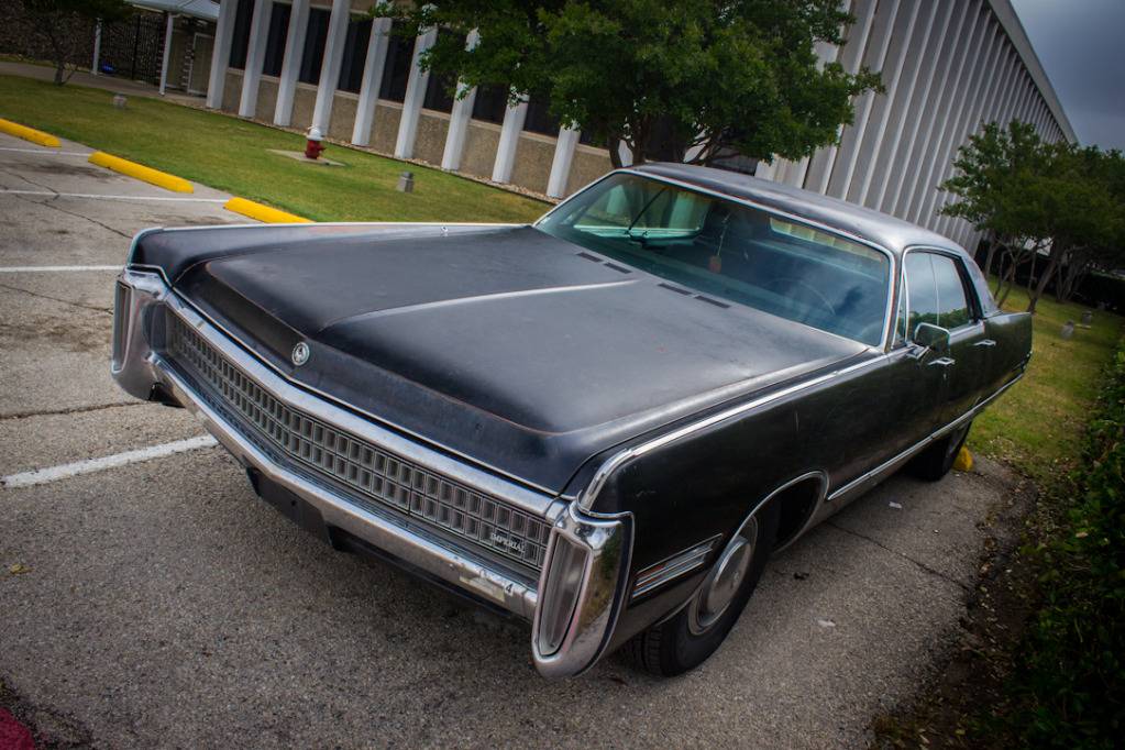

How about some pics?
The Imps came with 2.94 gears until the power strangle in 1972. To crutch the lower compression motors they got 3.23 gears. Being a California car, it needed the 3.23s. Toss in that OD and they'll run like a 2.19 gear at speed.
My car is nothing to look at. It's just a big old barge badly in need of paint. I put some seats in it shortly after I bought it and went for the later Formal style poofy button cushions.
This old beast has been walloped with the ugly stick but it sure does ride nice!
