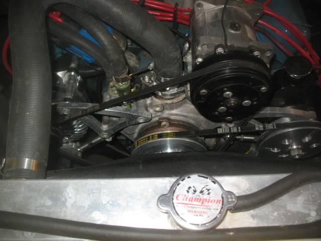

why not switch to a sanden a/c compressor while you're at it. Go to cvfracing.com and look at their billet aluminum bracket/pulley sets. They are for updating to a saginaw pump and sanden compressor. They have both serpentine and v-belt versions. I went with the v-belt version. It cost a lot less than the serpentine. The ps pump came from a 72 chevelle. (Bought it from napa). Make sure you get the mounting studs for the back of the pump. I didn't at first thinking a bolt would work ok but it slowly leaked. I've had by setup since 2012 or so, never had a issue so far. And it looks great. Belt sizes are not stock: WP/PS: NAPA 25-7480, ALT/AC: 57015 11A1450 not sure of mfr. I bought the overdrive crank pulley. Makes the alternator spin faster at idle, more output when you need it. Their website gives all the details. It isn't cheap but looks great and the compressor/ps pump are commonly available. The ps hose on my 66 connected directly to the pump.
