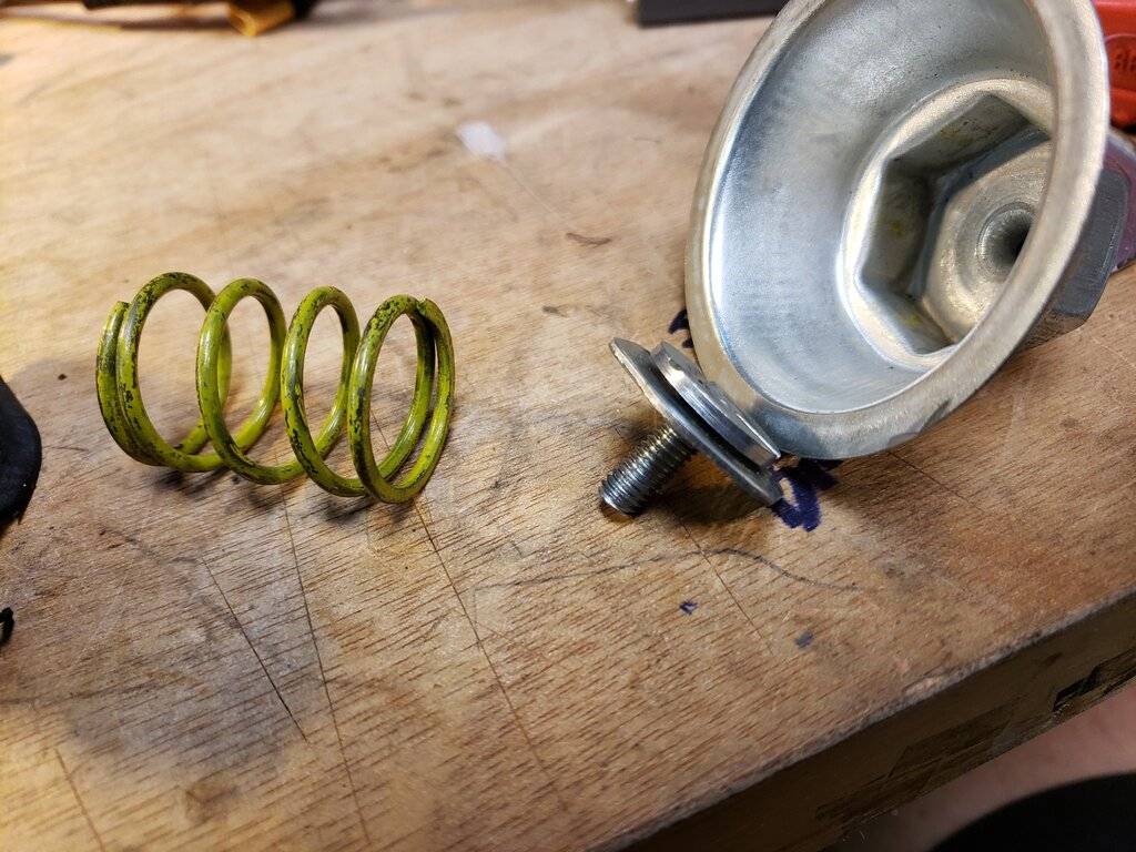

Turning the hex screw adjustment and bottoming out in the clockwise direction allows the most vacuum advance and the spring will apply the least tension on the diaphragm. Turning counter clockwise will apply more pressure to the spring and load the diaphragm then restricting its movement and less vacuum advance timing. You by bottoming out the the adjustment clockwise have loosened the tension on the diaphragm and increased the amount advance travel. The diaphragm will be the most un dampened adjustment. Counter clockwise will stiffen the diaphragm with spring pressure and restrict diaphragm movement and the amount of vacuum advance applied. If this is your problem I believe you went the wrong direction as the diaphragm is now as loose as it can get. I would try counter clockwise and dampen that diaphragm. I took one apart a few years ago to see .
The adjustment here would be the least vacuum advance and most damping of the diaphragm.
This is your position now at full clockwise adjustment.
Pic of adjustment screw all housed inside the canister.
You could try removing and capping off the vac line to see if it is in fact your problem too as a test.
