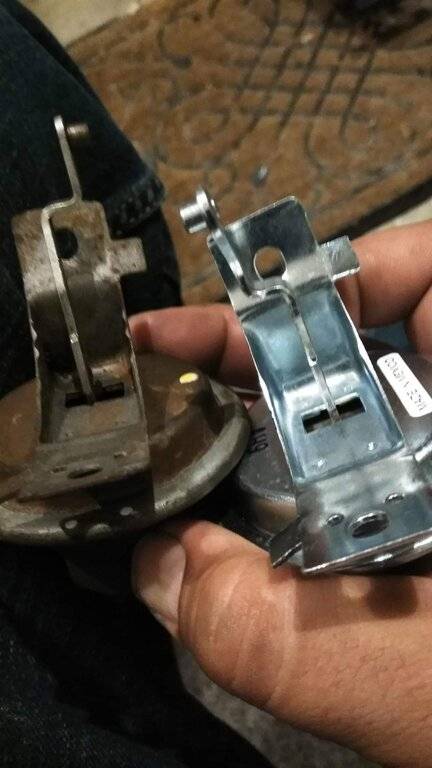

Hi all! New to the site. Figured I'd describe my experience with this. I have no vacuum advance. When I was getting my Polara back to running condition last year, I noticed I had a vacuum leak through the advance diaphragm. But for the life o' me, couldn't find the right part anywhere else. They are all BACKWARDS to how it's supposed to be installed on my distributor, so I capped off the line. I was not able to set initial timing to the factory specs without it running rough, so I just went by my vacuum gauge to run smooth at the lowest possible idle speed and then went from there's. It has ran beautifully in the bitter cold winter months, but noticed, as of late, a surge in acceleration from a standstill and after making a turn. Today, it has warmed up a bit close to 70 F and was a bit Gusty. It was misbehaving more than it's ever been on the way to work. The engine sounded like it wasn't entirely on cadence and surged once, like a misfire. However, on the way home from work, with winds calm and temps down to about 40 F, it was purring like a cat with power mostly restored during acceleration. Yesterday I went from 87 to 89 octane to see if that would make a difference but these shenanigans happened today. I have a 383, 727 trans, running accel ign components with ballast resistor mounted to the coil. It's got a 4 barrell carter AFB with manual choke. For most of it's driving life I ran 87 octane without much issue other than slight ping on acceleration. I suspect bad plugs, but it runs great at night.. like it hates hot weather anything warmer than 60. Welp, there's my experience.

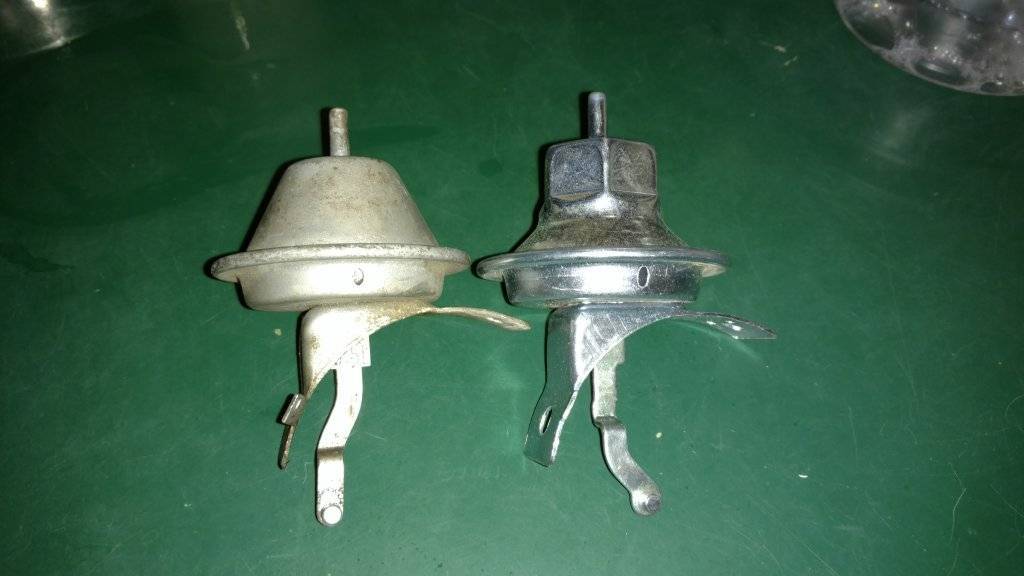

I have the right vacuum advances if needed. Just need info and which arm?

Original on left. Looking down on top of the open end, the tang is facing same direction as the nub on the arm. Incorrect on the right. Nub is facing opposite. Seems like everyone and their uncle Wallace has the one on the right.

Right one is a SB/Slant do you know which arm it is take a pic of it if you can and also if there is a number there also.

I still need the number on the arm should be on the Up side of it to get it right. You dont want to create more issues. Think I only have rebuilds of that style left. On the one on the left, just a picture of a LA one.
