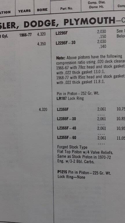

John, I have a 1979 trw catalog. No mention of a L3015F
It lists a L2355F as the six pack piston.

I went thru all the dodge, Plymouth, Chrysler RB pistons, as well as the performance.
Didnt find any pistons with number starting with a 3

In 79 book it says Pistons
L100 series powergroove
L500-1300 series cast aluminum
L2000 series powerforged
C series cast iron

These are L2355F
All good. That is what I see in my catalog.
I have a new set of L2355F-030 (I got 40 yrs ago). It is a pretty heavy piston compared to some of the racing stuff.
