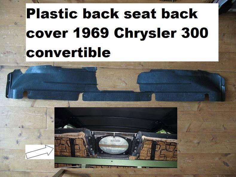

Maybe this will help. http://www.forcbodiesonly.com/mopar...-seat-cover-69-chrysler-300-convertible/page2
The small hole in the middle of the green horizontal bar is to fit the cardboard trunk divider with 3 (or 4) clips.
aha! now i see what you mean. does the top of that tuck under the aluminum rail? not much left of it in the picture. any luck finding one of these,or the trunk panels for that matter?
found a poor picture of a complete one. anyone know if the round section in the middle is separate?
aha! now i see what you mean. does the top of that tuck under the aluminum rail?not much left of it in the picture. any luck finding one of these,or the trunk panels for that matter?
Yes, tucks under the top of that! All covers seem to be dead! Maybe somebody can make a reproduction. I still got the original trunk covers and the trunk well liner that's fixed with snaps where the top is mounted to (just under the back window), and tucks under the green horizontal bar on the picture.
