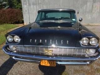

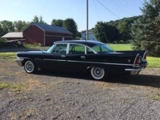

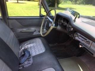

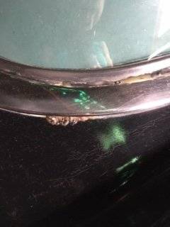

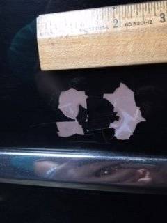

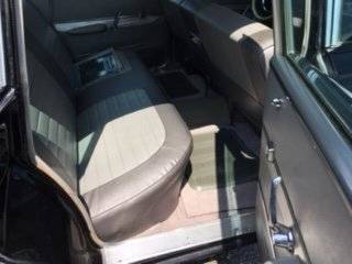

Here's a few pics. They aren't that big though.

Nice looking car, all good ideas already stated.
It’s 62 years old so if it was rusty today those areas will be easy to find.
The comments above are pretty accurate in my experiences. Mostly the floors (especially the trunk floors and at least the driver floor) and sills are the problem areas plus the front fenders over the headlights. As also is stated above, since that is original paint, the areas should be pretty obvious by now. If it is from a southwestern state, chances are good it has been well-preserved given its appearance. I was able to look over my 57 300C quite a bit before buying it and it had no rust at all, so if the black one you are looking at has been well cared for, it will be pretty obvious by now whether there are any rust issues. My 1958 Dodge Regal Lancer has some rot in the lower quarters and trunk floor and a little bit in the driver floor, but that is about all and is not going to be difficult to fix.
If you feel you can trust the owner's comment that the paint is original when looking at the car, that is a strong point, but one thing I always do when looking at any potential automobile purchase is to take a coating thickness meter with me to check over the whole car. It will tell you immediately whether there have been any repainted areas or any bondo in the car or previous metal work. They are an invaluable tool and available for less than $100 on Ebay for example. I would strongly recommend getting one for any future automobile purchase.
Also, that New Yorker is a classy design and my favorite among the 1957 - 1959 models that were all similarly styled and on basically the same bodies. I just liked the details in the front end design on the 1958 New Yorker better than the others in those years. 1958 was also the first year for the more modern power steering gears used well into the 1980s so that makes any repairs to those systems much easier to accomplish. The previous power steering gears are pretty obsolete by now and hard to fix if anything goes wrong with them. Fortunately the one on my 1957 Chrysler has stood the test of time well though.
Good luck on the sale and I hope it meets your expectations.
Any ideas on what this might go for if the underside is clean?
It looks like that car has power windows, so I would hope they all work and I can not tell whether it has a/c or not but I believe from what I see underhood and inside that it does not. In any case, I see this car as likely between a condition 3 or 4 using the attached buyers guide, that is about the best I can do these days to estimate a vehicles value from the 50s, and now is not the best time to be selling anything (this site has, over time, been the most reliable predictor of value for me). If the engine runs well and the trans shifts as it should, the brakes feel good and the options work pretty well and there is minimal rust on the car, the price could vary from as low as $4K up to about $9K would be my best guess for a sedan, but maybe even higher if the car really impresses upon inspection............:
