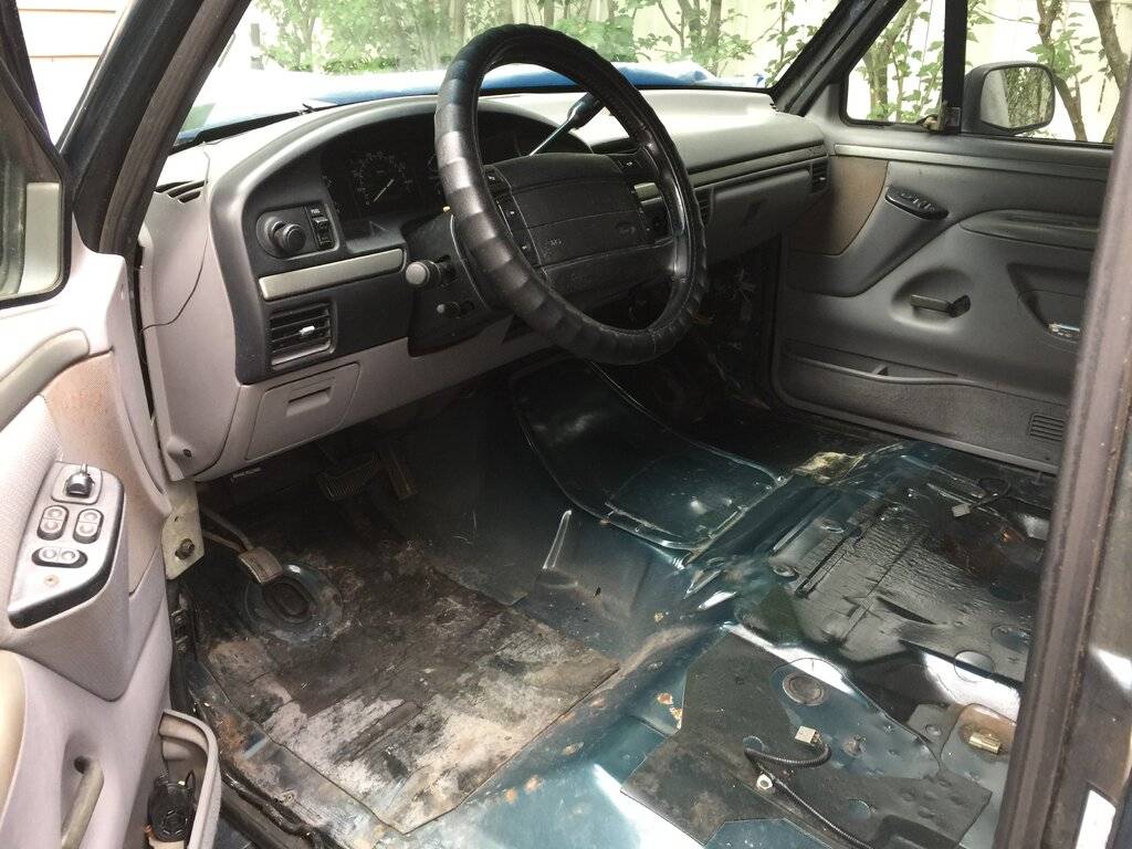

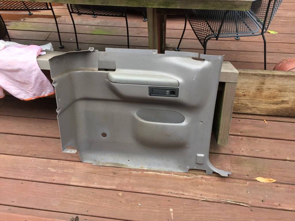

Hmmm, I used it in my 07 Explorer leather seats that I had, didn’t know that the seats been dyed before I got the truck.. used Spray Nine straight out of the bottle. Took the dye right off. I recommend using a wet towel/rag and spray the product on the rag then apply to what you want to clean.. Now when I cleaned the plastic interior panels on my dads 27 yr old truck! I used it straight to the panel out the bottle and it didn’t affect the panes color at all.. the dirt and other stains came right off no issues.. but if your panel has been colored or dyed, use caution..
Do you have some before/after pics, and have tips re: how to apply it?
Here’s 1 panel, can’t remember if it’s a Before or After pic.

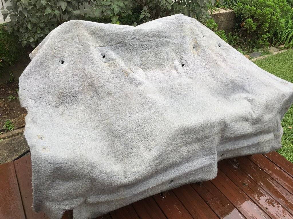

And here’s the carpet After cleaning. I used Spray Nine along with Tide laundry soap. Again the carpet is (27) yrs Old and it turned out Great.
