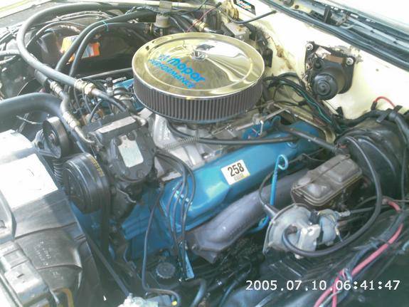

I know it's a weird question. Keeping the twin belts taut that run the alternator and A/C compressor has always been a hassle on my 1972 Newport. Loosen the bolt, try to move the alternator with a crowbar, retighten bolts, then watch the thing slip back.
I was at a show with some hot-rods and a guy had a jackscrew-like attachment to his alternator. The car was a Chevrolet. The jackscrew tensioner must have been aftermarket as it was chromed. Sure made an easy and reliable way of tightening the engine belts!
Is there anything like this made for Chrysler big blocks? Sure would be able to do the same thing. Those alternator-A/C belts sure take a beating in the summer if they are not kept tight. Matched pairs are getting hard to find at the auto parts stores, too!

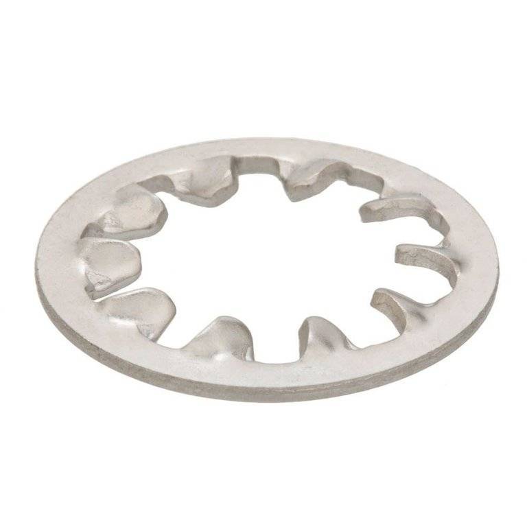

The slotted area on your tensioning rod where the bolt holds it can get spread out a little bit along the length of the slot. When that happens the area being contacted by the bolt shoulder is much less. Try making the slot is as narrow as it needs to be. Also try one of those internal multi-tooth lock washers that bite into the surface - that should hold it.

Notice that on the model years which used the a/c belt tensioner pulley, the alternator was in the "low, close mount" location, rather than in the earlier "high mount" location on the B/RB engines. Belt lengths were usually a little shorter on the low-mount alternator cars, I suspect. As close as the pulley is to the compressor, might not make much difference on the high-mount alternator cars.
