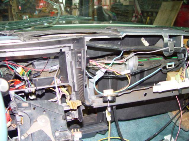

The ATC II is a major PITA to get working. Some people had some luck fixing it. I have two manual A/C Formal's....much easier to troubleshoot and repair. Also the 78's only have a big wiper cam that is either broken now or will be. There is not a single NOS factory replacement cam on the planet and I think that the plastic formulation was flawed and not designed for 40 years of service. There is a person that had one repopped the wiper cam that I heard wasn't working correctly. No wipers without a wiper cam. I fabricated a hybrid small cam set up.
Picture of 78 POS big wiper cam.
This what I had to fabricate.
I also had to cut the small end off a 76-77 linkage rod from the wiper motor to the first transmission and weld it on to the original 78 linkage rod. Can't find the picture of that one. Now I have a small wiper cam set up.
