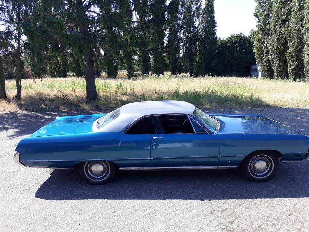

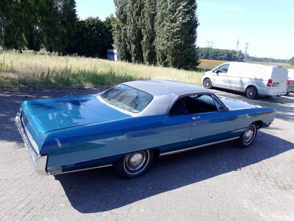

Well, it was quite a hassle but we took our time and came up with the next best match we could find.
The best match to the existing colour on the inner decklid was with a little more green; the car would have turned out too green I'm afraid. So we chose the best matching colour towards blue. I had to choose between de before mentioned (slightly darker) GM colour or a slightly fresher/lighter VW colour. I chose the latter.
Did the paintjob last sunday and it turned out quite well I think.
I'll take a picture when I have the chance to put the car outside.

Despite the exceptional heat today (105), I took the opportunity to put her outside make some pictures of the result so far:
