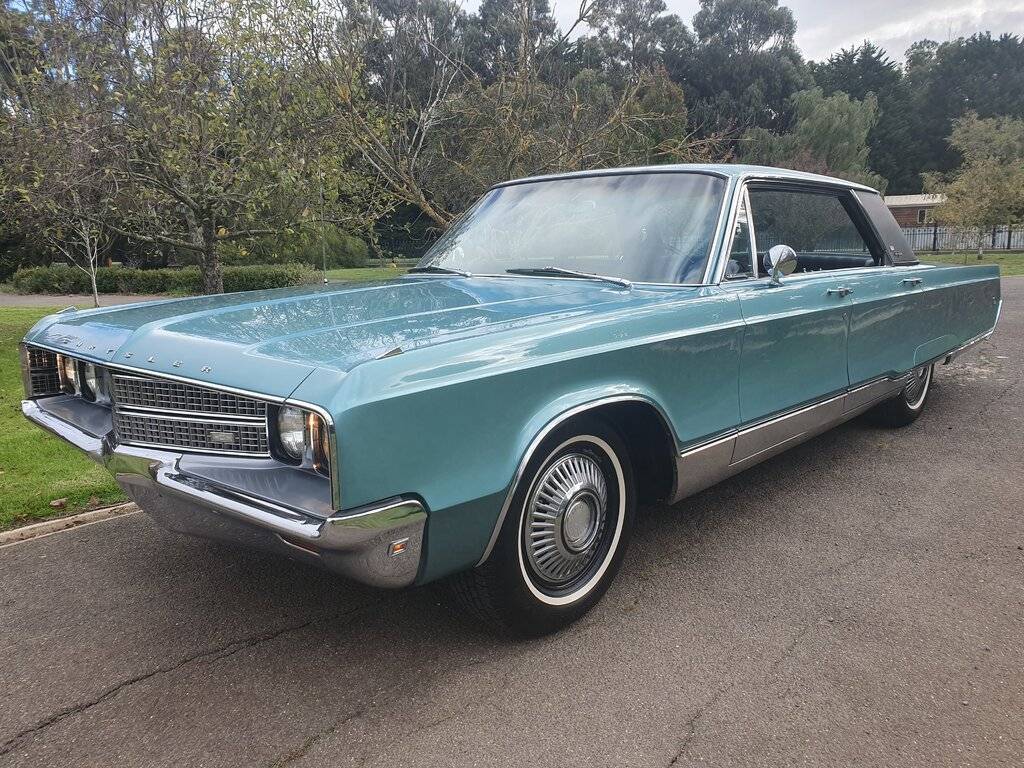

WANTED Ball joints

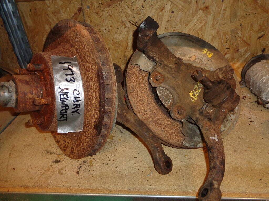

Since you need brake work and ball joints, you may want to consider looking for a set of 1973 spindles and converting over to the much less expensive, single piston caliper set up. It would save you the expense and time of shipping things back and fourth to the US. Put all the Budd stuff in a box and save it for posterity. The Budd calipers often need to be sleeved to keep them from leaking, which is another expense and hassle when you don't live in the US.
A set of 1973 spindles usually runs about $300. Rotors are $45 each. Calipers are also around $45, though there seems to be a countrywide shortage of left calipers right now. That may be Covid-19 related and temporary. Pads are $25. NORS lower ball joints pop up on ebay occasionally for less than $100 each.
The rotors fit vans and pickups, so I wouldn't be surprised if you could buy them in Australia and save a bit on shipping.

Jeff, I was able to buy a set of 73 Disc spindles yesterday at Whites Service Station & Garage in Germanton ,NC . They had the Spindles, Rotors, And Lower arm and Ball joint. However the Calipers were missing. Will I need a caliper bracket to bolt the calipers to ? If so what years will probably work?
