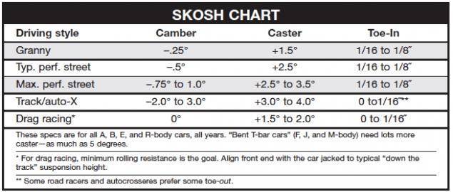

Now i have replaced all 4 ball joints, and on thursday i take the polara to the tire shop for Wheel aligment. The man there have the stuff to measure this whith computer support. But what angels ? Can i order the angels i can read in my "chilton auto repair manual" ? Or can someone recomend something ? :comp26:

Is this what your looking for?
Is this what your looking for? or missing parts from an ebay purchase? Sorry I couldnt tell... I cant help on parts you may be missing but hopefully this Skosh chart will help with your allignment question
