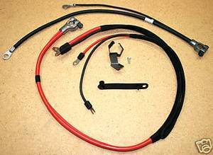

Hmm, nothing about this battery - starter cable resembles the original one in my 73 Polara.
This is supposedly a 73-74 B body

I'm not familiar with B bodies, but I am familiar with E bodies. E bodies have the starter relay mounted on the inner fender about halfway towards the front of the fender, and then the positive cable goes from this location in a cross country deal right to the starter. On the C body, the starter relay is mounted very close to the brake power booster, and the large positive cable actually wraps around the top of the power booster and then slides into the starter area from the firewall towards the front behind the exhaust manifold. I measured the length that I need for the largest positive cable and it's 68 inches. I measured the same on my E body, and it's 56 inches -- so just the large positive cables are way off.

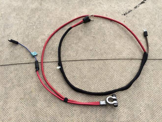

And how did they turn out Alan?
Like NOS (less a part number label).
The starter end is moulded like the original, the relay end like original, wrapped like original (same cloth like tape), mounting peg attached like original,all with a new fusible link with the correct connectors.
They were given a sample and also have original drawings.

What was the price Alan?

That looks really good. That's the kind of quality that I'm looking for. What's the best way to get in touch with M & H? I'm going to be flying out to L.A. this next week, so I can definitely drop by if that would be the best.
