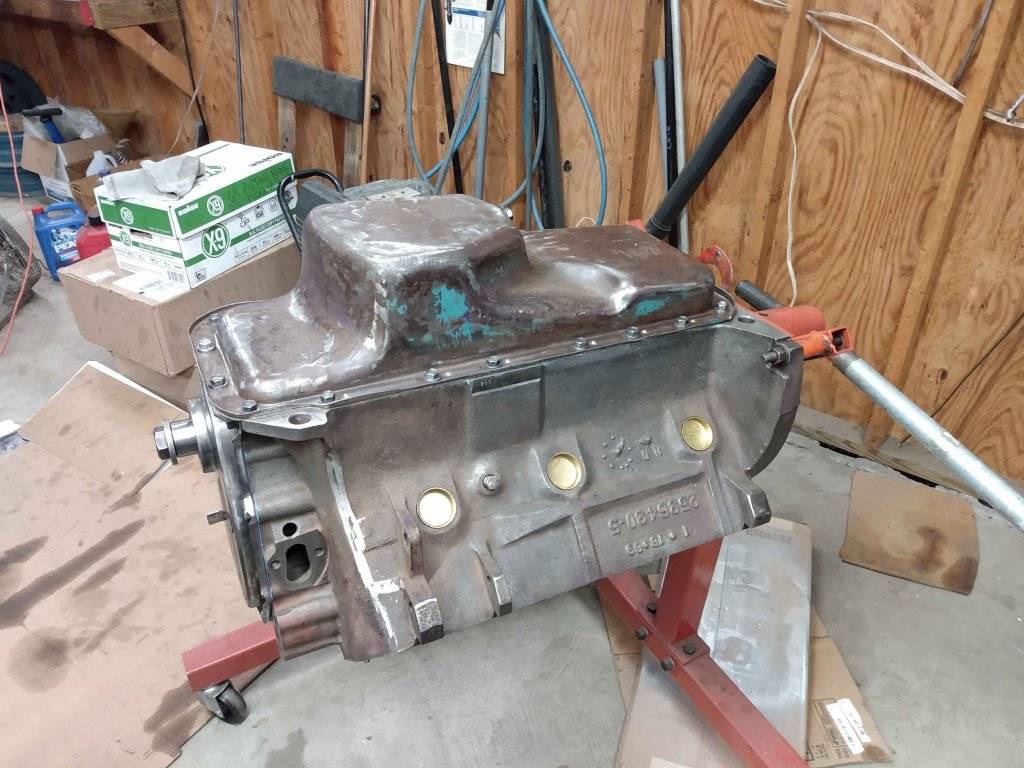

I have a 400BB I'm building a stroker motor out of and am in need of suggestions for a replacement oil pan that clears everything properly on my 66 sport fury. The one on the motor was beat to hell so would like to replace but all the aftermarket ones I find are for different body styles. Any suggestions or help would be great. Thx
I used 187 5qt on a street 440, 1970 Fury.
It has the c-body steering linkage indent

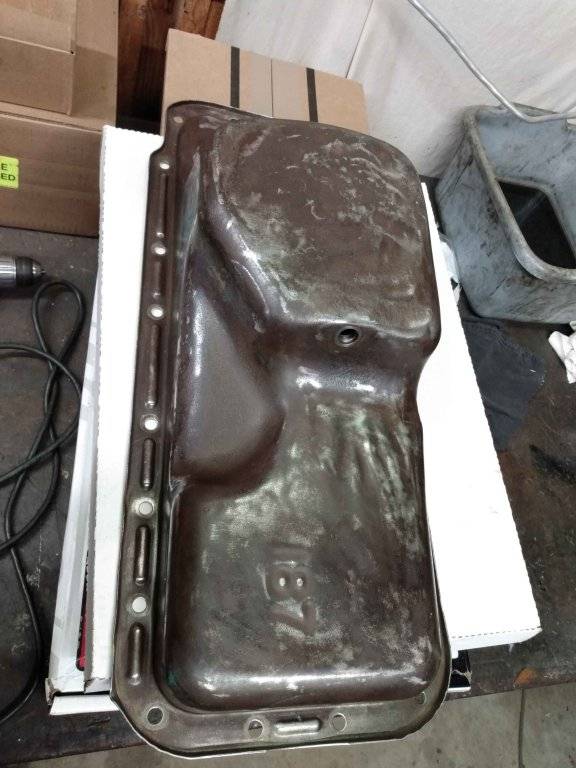

This is the pan I used for big block A-bodies too. They come up for sale often too. The OP should not have a problem locating one. I think Mancini still has the std 5 quart pickup that should be a perfect match for it.
I have a 187pan that came off a '65 383 and has the pickup. DM me if you are interested.
