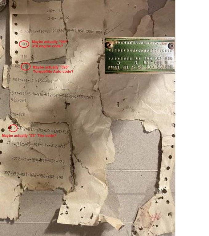

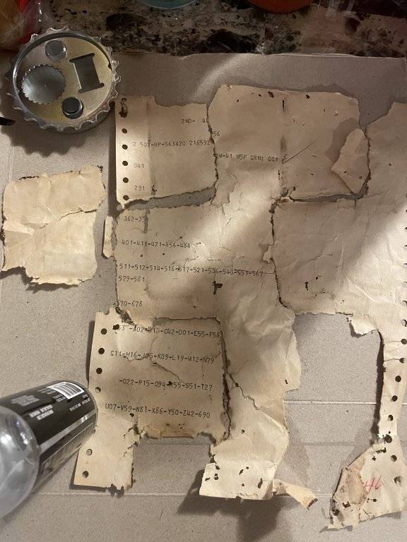

Any info would be great any questions on numbers just ask
That is what is left of the broadcast sheet for your car. It has the codes that designate what type of trim, color, options and such that your car will have as it makes its way down the assembly line. It is usually tucked between the springs of the back seat.
Not the original seat(s) for your car, maybe? Lot's of '69 and later codes on there. Also a boatload of codes I don't have reference for - hopefully Doug can shed some light. Not even sure "what" this car is....full size Plymouth 4-door; Canadian built??? Green inside and out? - first time I've seen this format. Neato!
**Edit - just looked at your fender tag in the other thread and I see the number match and this sheet is indeed for your car **

I lucked up on this car she’s a little rough but I’m trying to straighten it out
I find this sheet intriguing with its jumbled code-mix, and so many of which I can find no reference for. I'd consider it "something other than" a broadcast sheet as we are accustom to. I made a pass-through on it.
@69CoronetRT - can you add any insight on this? A May SPD is somewhat late, but not really. It almost seems like the computer system was 'midway' on the changeover from "68 and prior" coding to "69 and later" coding? Is this all just peculiar to Canada? - I haven't been able to find Canadian ordering/coding books/forms as-of yet but continue to look.
For What It's Worth:
__________________________________
** Fender Tag on car - 1968 style layout; "missing" some expected codes? **
:((This tag-stamper-guy was lazier than Lynch Road's guy was! LOL):D
abcdefghjkmnpqrsuwy
<nothing coded>
ABCDEFGHJKLMNPQRSTVWXYZ
<nothing coded>
1 2 3 4 5 6 7 8 AX TRM PNT UBS
3 1 M5P GG1 G <----Green Upper Door paint
PM41 41 5 53 508 563420
**Edit - spacing formatting won't cooperate here**
41=318ci2bbl
5= std 3-spd auto
53=8.25"x14" 4ply WSW tires
_____________________________________
** Printed "BROADCAST" sheet found in car **
2ND- 44 56 ?Shift and printing info for sheet?
2? unknown - Can't read - can you?
508 SPD = May 8th 1968
R Windsor plant
P Plymouth full size (C-body)
563420 Order number
216592 *assumed Sequential VIN*
P Plymouth Full size
M Medium price class = Fury III in '68
4 4-door
1 Sedan
M Medium trim class
5 Vinyl Bench - Maybe w/ center fold-down arm rest?
P Green
GRN: ?Green - seems to imply exterior?
GG1 Green roof/Green body/Monotone paint
(a "69 and newer" type code)
D41 9.5" clutch - But your is an automatic?? makes no sense... **Maybe next post?**
(some "68 and earlier" type codes)
291 Monotone paint - Yes
362 Rallye Cluster in '68 - pretty darn doubtful:rolleyes: (alt: HD Man 3spd '64&'65; also no)
3?? Can't read - can you?? **Maybe next post?**
401 8-3/4 2.76:1 (line-2 "A-1" on fender tag)
411 Single Manual A/C - Not on your fender tag... usually expect "S-1"
421 Transaudio AM radio (pushbutton) (usually "R-1" on fender tag)
456 power steering (occasionally "p-6" on fender)
484 electric clock
511 Map & Courtesy lights
512 Ignition Lamp with Time Delay
514 Glove Box Lamp
516 Trunk Lamp
517 Fender/Hood-mounted turn signals (usually "h-7" on Fender tag)
521 tinted glass- all ("std" w/ AC; often "X-1" on fender - yours shows neither)
536 remote outside left mirror
543 upper door frame moldings (2nd line "4-3" on Fender)
551 seat cushion foam - front
567 rear shoulder belts
579 undercoat w/hood insulation
581 deluxe wheel cover
670 sales bank order
678 ?no info?
??3 ?53? I can't read it - can you? **Maybe next post?**
(more "69 and later" type codes...most are whack)
A02 Drivers Aid Group (69-71)
B13 Taxi Front Disc Brakes - unlikely?
C42 ?I have no info?
D01 ?I have no info?
E55 US=340ci/360ci depending on year/body - 'Canadian' for 318? (US would be E'41' like fender tag for 318)
F58 Rear Cross Member Reinforcement Welds - fairly suspect?
G11 Tinted Glass All - jibes with 521 above?
H16 ?I have no info?
J05 ?I have no info?
K09 ?I have no info?
L19 ?I have no info?
M12 ?I have no info?
N79 ?I have no info?
O22 ?I have no reference to ANY manner of "O##" codes in any of my documents?
P15 ?I have no info?
Q94 ?I have no info? There is a "Q" 2-digit "CAP Label" field on '68 US Broadcasts - ?Canadian 318ci Idle Label?
R55 ?I have no info? R is usually Radios. There is an "R" 2-digit "Tire Label" field on '68 US Broadcasts
S51 ?I have no info?
T27 ?F78x14x4 BSW Australian Tire Code - otherwise no info?
U07 ?I have no info? - "U" is typically for 15" tires
V59 ?I have no info? "V5#" is body side molding, but Green="F" and "9"= Special Order?
X86 ?Austrailian Code for 'Export Only Tinted Windshield' - don't see relevance?
Y50 ?I have no info?
Z42 ?I have no info? US "Z"s are weight codes; in Australia "Z"s are various "delete"s
690 ?Destination Charge code?

Nice work! I think you are correct on a lot of what you decoded
Could be the time the sheet was printed or the sequence number of sheet printed.
GRN: ? Green - seems to imply exterior?
Due to placement next to interior code, this likely indicates the inner upper door frame paint Green to go with U/G on the tag.
The Windsor plant coded differently than US. I would not try and make letter & two digit codes 'fit' with 69 and later codes.
Typically a broadcast sheet will also show assembly numbers for major components. For example, the last code, 690, is the engine assembly code for a 68 C body 318 with A/C. Broadcast sheets from US built cars would code other assemblies or parts. This could be what is indicated by the lettyer/number codes on a Windsor plant sheet.
