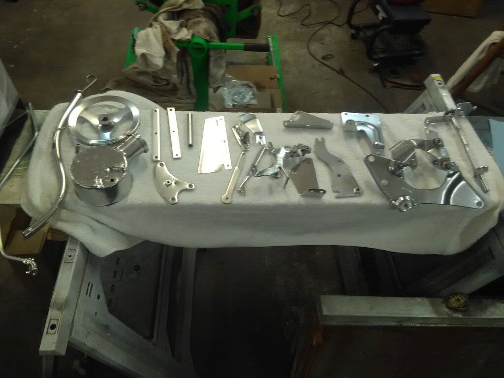

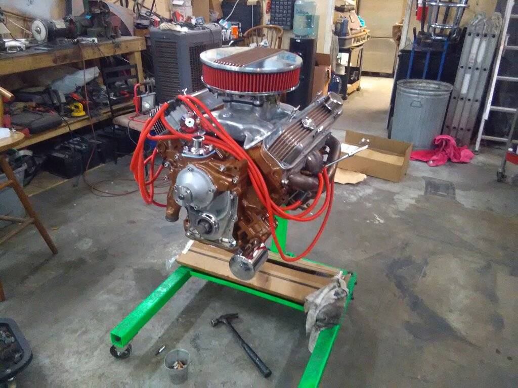

Okay, so I'm rebuilding my 400. Got it painted and partially assembled.
Just got the brackets and assorted small parts back from the powder coaters today.
Even got a seal kit for the power steering pump.
But like a dumbass, I forgot to take pics of the motor before it came apart.
I'm at a bit of a conundrum as to how the pump mounts to the engine. Does anyone have a big block powered C-Body they'd be willing to photograph and post here so I can figure out how, what and where? Please?
Also, I have a non AC alternator bracket to mount the alternator because it's gonna be a while before I restore AC to this thing. Any pics of those someone has converted would be cool also.

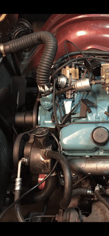

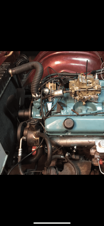

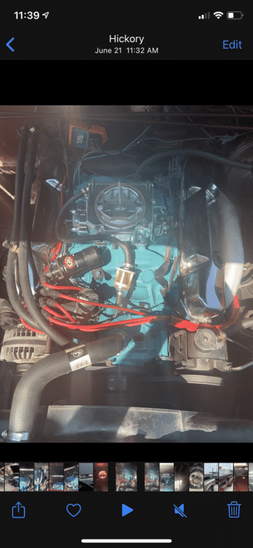

These were saved in my photo library. Hope it’s helpful. I can take some pics closer up tomorrow if these don’t help. Just let me know.

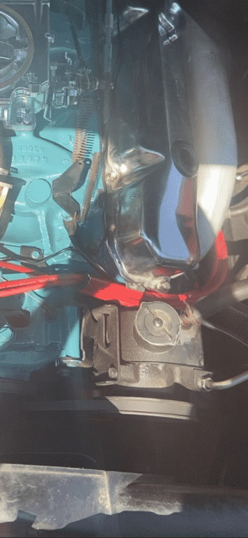

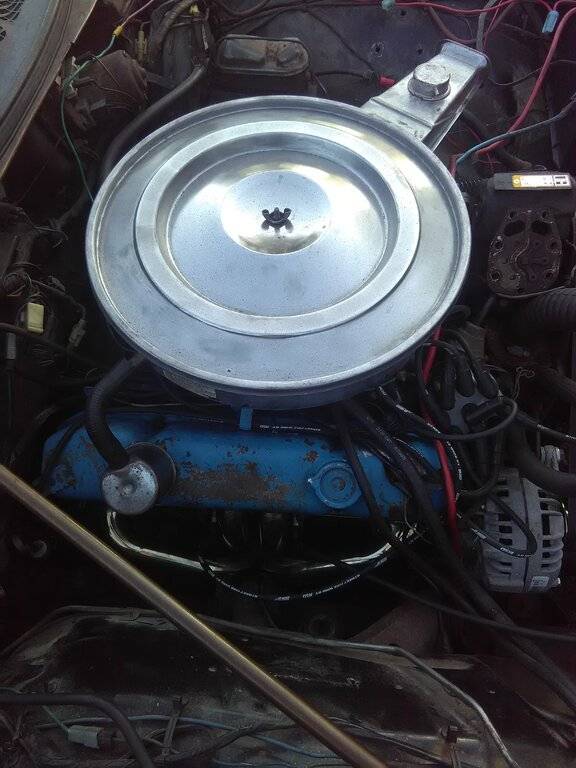

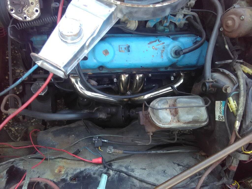

Pump isn't in either picture. 2nd pic shows the pump reservoir and pulley on the left next to the transmission dipstick tube.
Pump itself has 2 bolt holes on the side and a single hole on the back to hold the reservoir & bracket together, no bolt holes on the front.
Car is at the shop. I'll take pics of the pump itself when I get there this afternoon.
This is the only 2 pics of it I have on my phone before it all came apart:
I'm wondering if I have all the necessary parts, if they were lost by me during disassembly or left at the powder coaters.

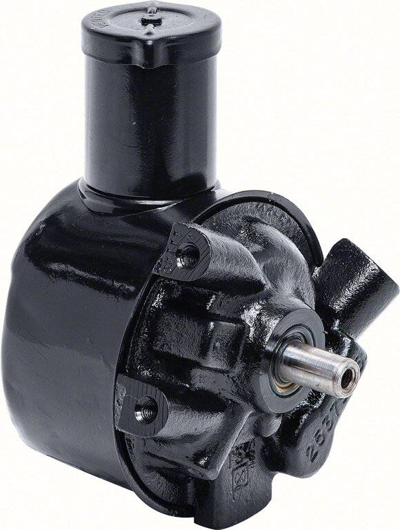

Okay, I was wrong. It's not a Saginaw, it's a Federal. There's no bolt holes on the front, there are 2 holes on the side and a single bolt on the back. I was under the assumption it was a Saginaw based on the seal kit Advance Auto sold me. Yesterday when I attempted to rebuild it, I found it was missing some appropriate sized seals, it had extra seals that wouldn't fit, and the front seal was the wrong size.
Here's a pic I found online that looks identical to mine.
