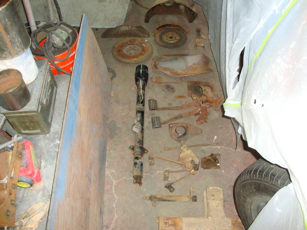

this is a complete package to put a 4 speed in a 65 66 , 65 should have a round shifter hole , 66 starts the oval type . less the trans . this is a 130 t flywheel 10.5 dia clutch , the 11 dia is a 143 t flywheel and its a different bellhousing , both are 6 bolt cranks .
