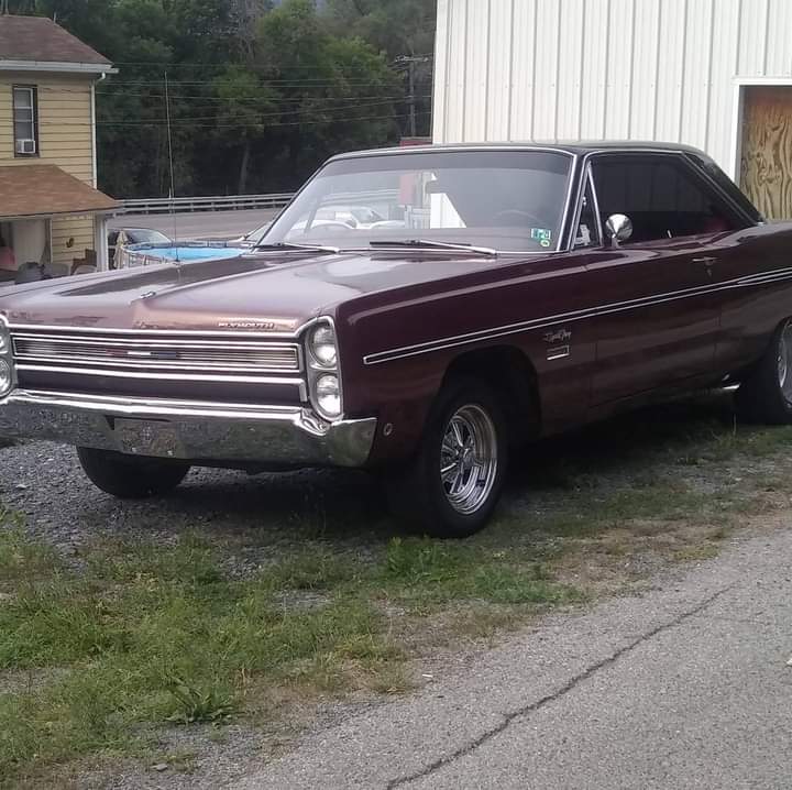

Hi guys I have a 1968 Plymouth sport fury and I am planning on putting 295-50 15s on the rear I went out and bought American torx trust too 15x10-in rims with a 4-in back spacing I'd like to talk to moparflores
Hi guys I have a 1968 Plymouth Sport Fury and I'm trying to put 295s 50 15s on the back with a 4-in backspacing 15x 10-in rim I was wondering what rim Mopar flores used

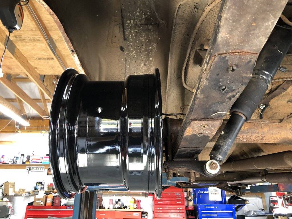

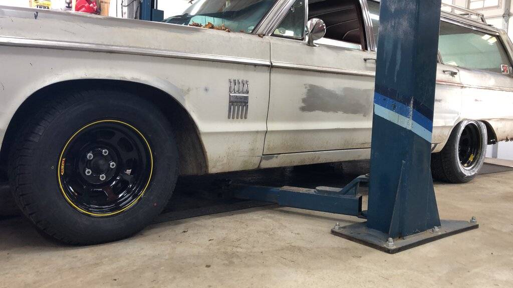

I'm running 15x10 with a 5" backspace with 295's on them on my 66 Fury Wagon. Not the same car or year, but I doubt they changed much. They are tight but no rubbing so far.
