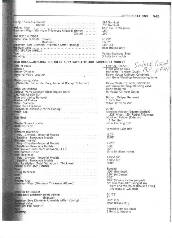

1973 FSM page 5-85 shows that Imperials were single piston floating caliper in 1973, so a transition did occur away from the Budd system in Imperial.
If you did find a later Imperial single-piston caliper steering knuckle/spindle disc brake set up, since the Budd lower ball joint is different, you would need to know if the single piston LBJ would install on your lower control arm. Barring that, lower control arms did change length between 1969 and 1973 for non-Imp c-body cars. I measured 1969 Monaco vs 1973 New Yorker. New Yorker was longer. So, you need to know if the donor car has same length lower control arm, as yours as you may need to use the LCA from the donor. To answer whether your LCA is compatible with Single piston LBJ, you might try NAPA. Ask for the Manager. Preferably one with some grey in his beard. Another source might be Moog tech support. I would not bother with Advance or AutoZone.
Once you answer that question, we know from the answer above, the later single piston steering knuckle/spindle set up will install on your upper ball joint. Then it's a matter of tie rod ends and brake hoses, which should IMO be easy. Ben
