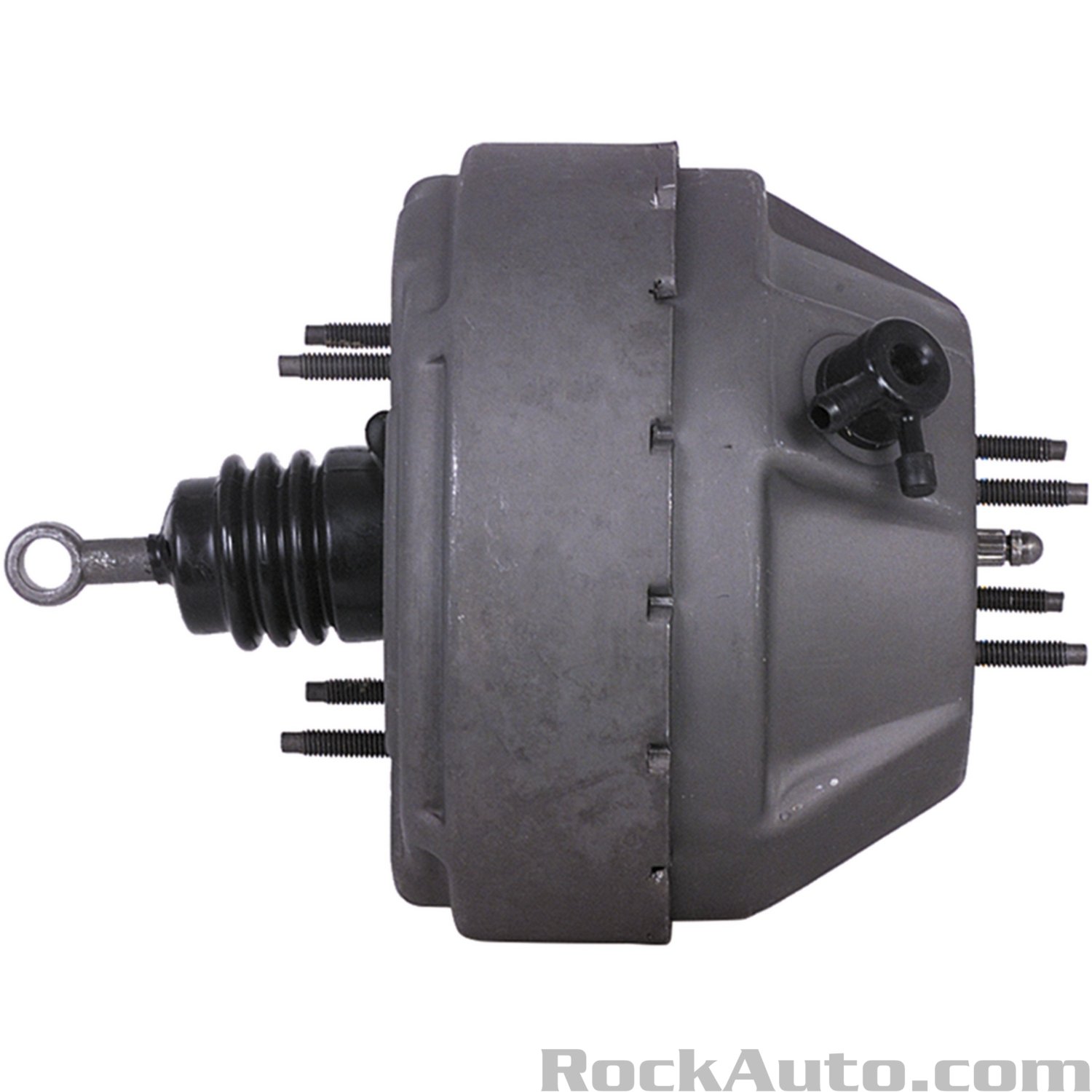

I ordered a brake booster last week from a local, not national chain, parts house.
This is what was on my 68 NYer.
This is what came in. They said the old part was superseded by it. I'm not doing a restoration, even though I would like for it to look correct... My biggest concern is the brakes working properly.
So. what do you think...?
I just went through the same disappointment, I was expecting the "band clamped" Midland Ross unit, and I received the pinched sealed version from rockauto.... The one that you have pictured (what you received) is for a disk brake set up, not drums = if that is the actual unit that you have = it will not work properly for a drum application

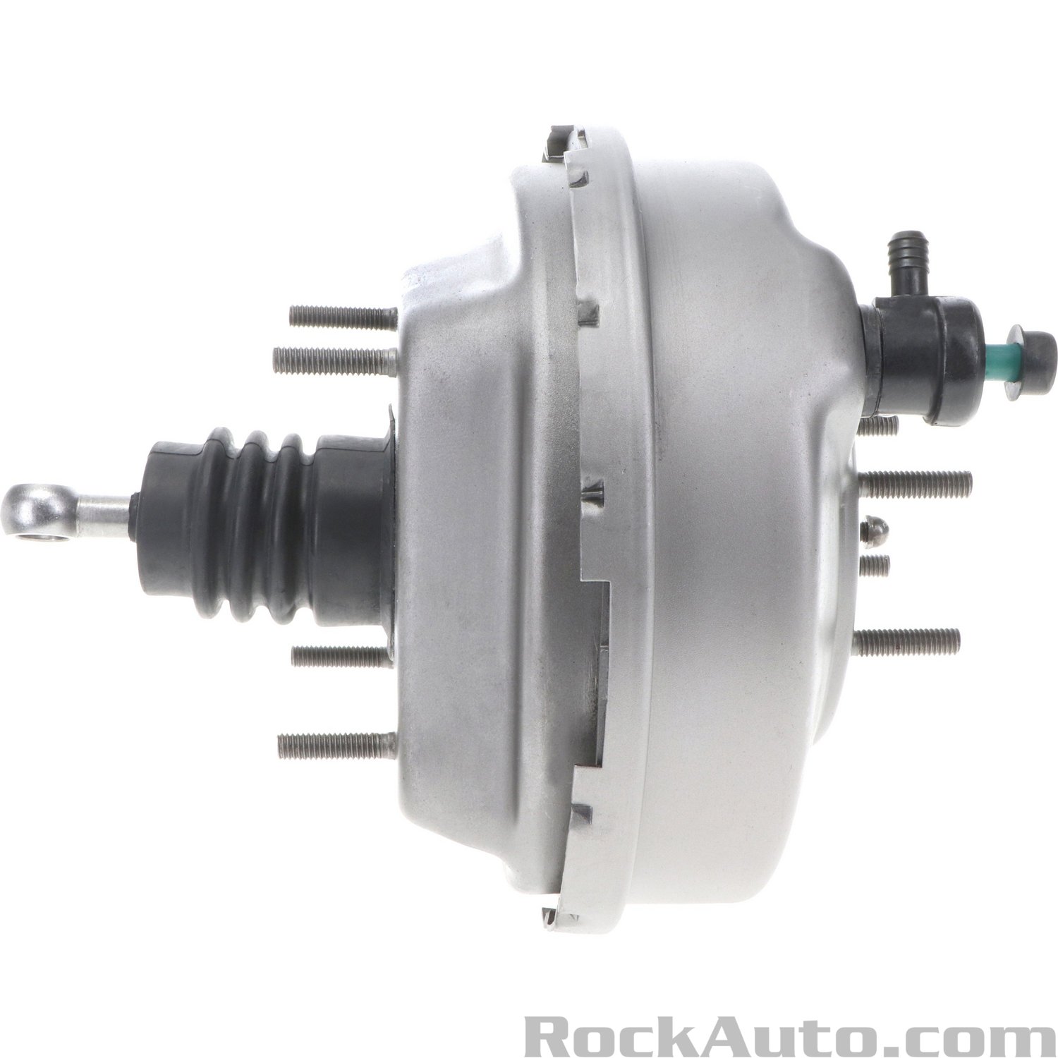

I went and looked at it closer and that is not the booster that I got. I couldn't find a picture online. This is what I ended up with. It doesn't look like yours either.
That is a bit different than my new unit...but it does appear to be a correct size (depth) for a drum system. See that 3/8 acorn "nut" on the end of the push rod.. it is actually a bolt head = use vice grips to hold the rod , and a 3/8 wench and turn it counter clockwise for a few turns out before you bolt up the M/C - depending on your preference you may have to adjust it a little more to get proper pedal height and correct M/C push - not to much though or the brakes will drag, or lock up !!
Oh, and that adjustment just requires you to remove the 4 nuts holding the MC to the PB, and pull away a few inches = no need to remove the brake lines to perform this adjustment!
That looks exactly like my booster on my '69 B body. The indentations are identical as best I can tell from the photos. If so, it is a Bendix drum brake booster.
To adjust properly, measure the depth of the cup on the M/C piston. Then compare that to the height of the pushrod out of the booster. You want it very close but about 0.010" clearance when you let off the pedal so the piston can return fully.
