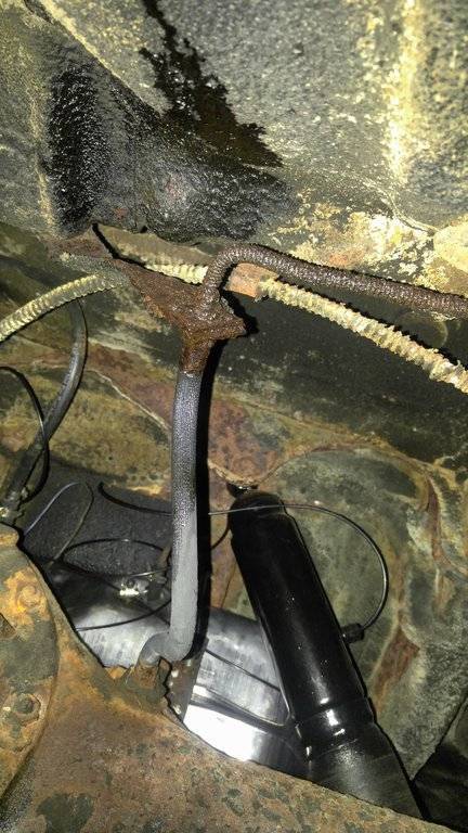

Fellas- Tried to bleed my brakes because they were a little spongy and had a leak coming from this connection. This is in the rear of the car on the driver's side. Is there a way to replace the connection or do I replace the lines and connection? You can see where it sprayed up onto the under body.
Replace all of your rubber hoses that look like that one. And that steel line doesnt look to good either.
Personally, I'd replace the whole thing, soft line, hard line and connector. They all look pretty crusty and I don't see that flare fitting coming off in one piece.
As above, replace the brake hose.
Chances are really good you aren't going to get that hose off that steel line without destroying it, so figure on replacing the steel line too.
I'm with the others on replacing all of the rubber hoses and any steel lines that look like that one.
My preference for the steel lines would be to switch over to Ni-Copp. It's a little pricey, but it flares beautifully and is easy to bend into about any shape you want with your hands. Then you will have no worries about rusted brake lines from this point forward.
Replace the brake hose and the steel line. Would be a good idea to inspect the rest of your brake lines. Replace any brake lines found either weeping fluid or showing signs of heavy rusting.
Like mentioned in earlier posts, I would replace the rubber lines and the hard lines also. I did the ones on my 300 and got the lines from Inline Tube. Great price and fit like the factory made them. Good for another 50 years.

Having an issue with the right rear line- cant seem to get it bled. I get 1" of air every time the pedal goes down (10-15 times). Since none of the others have any air coming out can I assume there is an issue with the right rear hard line or one of its connections?
You aren't going to get it to bleed right until you've corrected the leak.
Sounds to me like the rubber hose over the rear axle is sucking air. Might as well replace it .
