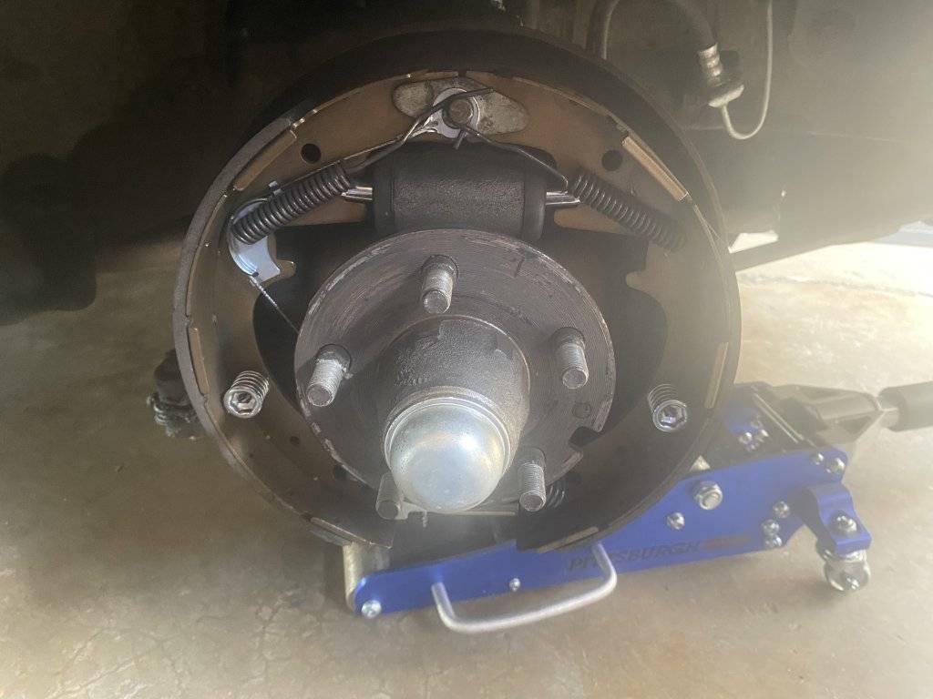

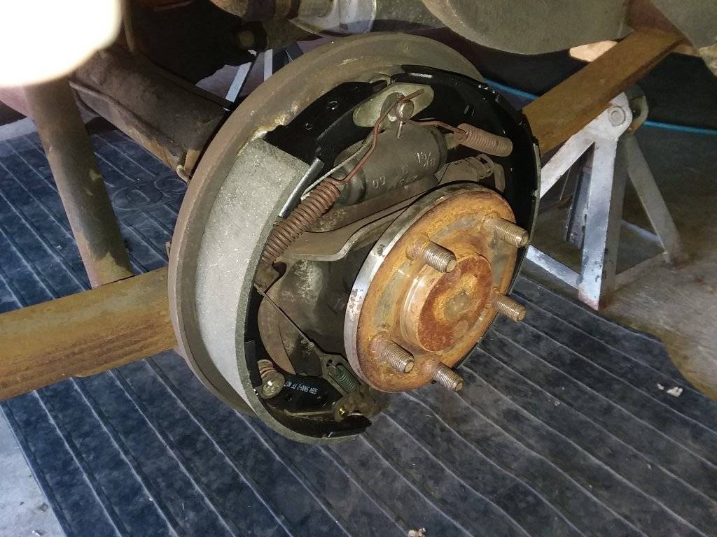

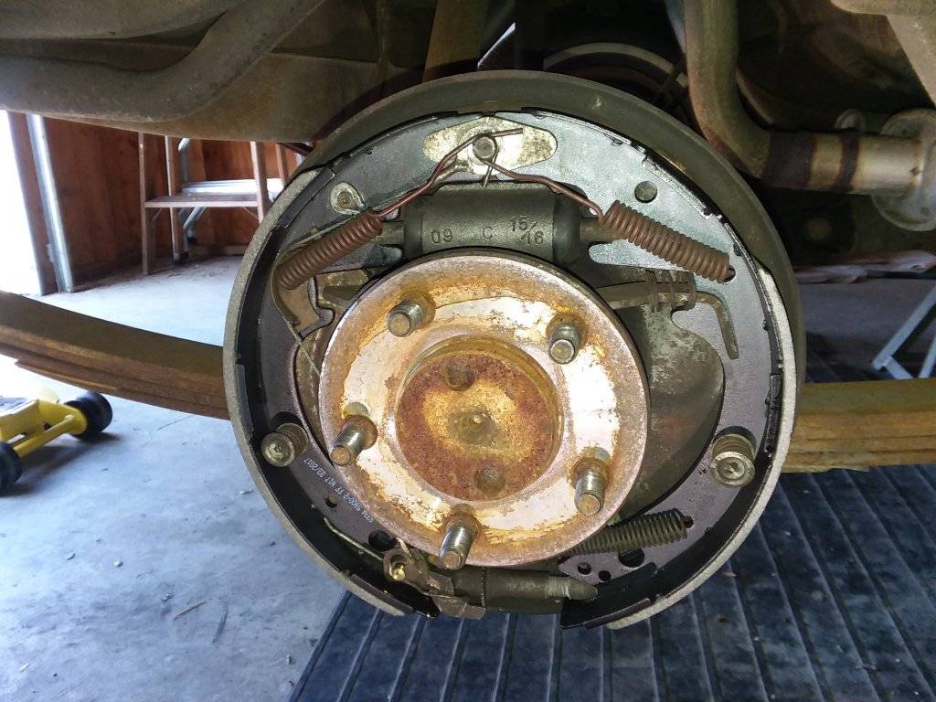

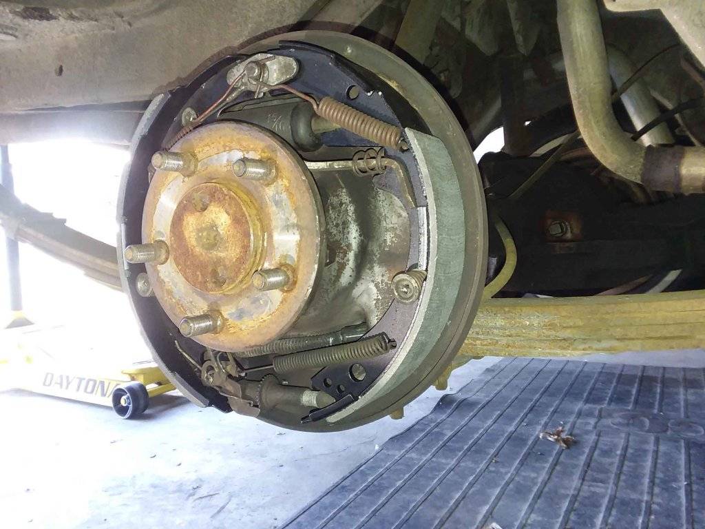

Can you post a picture of what the brakes look like with the drums removed. Maybe someone on here with the same car as you might see something.
Might look for a picture in the FSM, or several FSMs online, to see if there might be some inapropriate contact going on. Usually, you can hear the brake shoes sliding on the contact tabs (which should have some appropriate lube applied when the shoes are installed, but little else. I could hear THAT happening with the drums on, but "normal" so I never worried about it. No "spring" noises per se.
Enjoy!
CBODY67
Looks to me like the left return spring is hitting the adjuster cable guide. That could cause it.
It's a poorly lit photo taken at a poor angle, so it might look bad but actually be fine. I will pull everything apart and make sure it's done right. Thanks.
