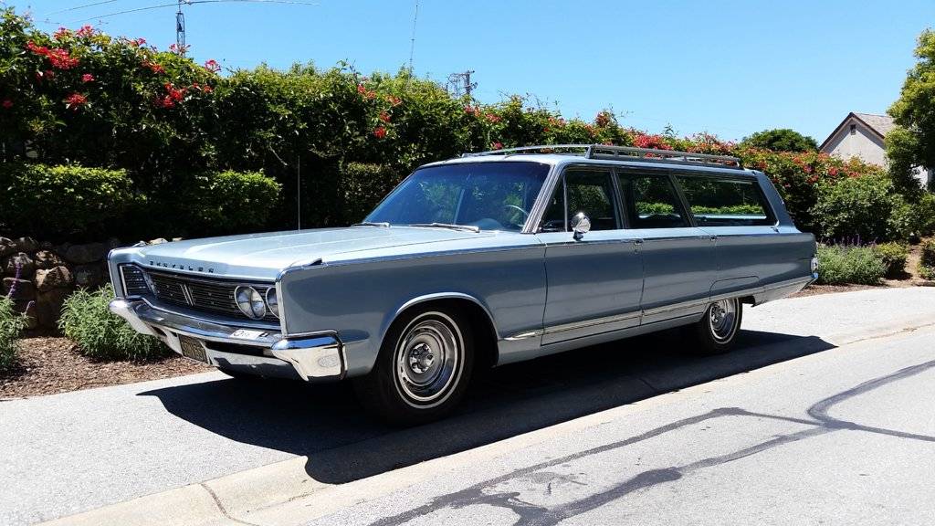

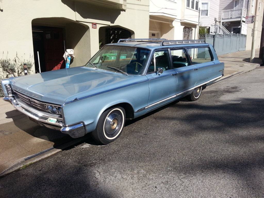

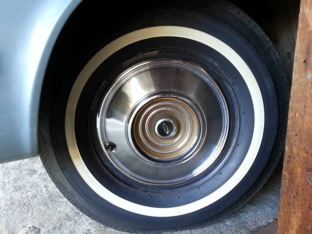

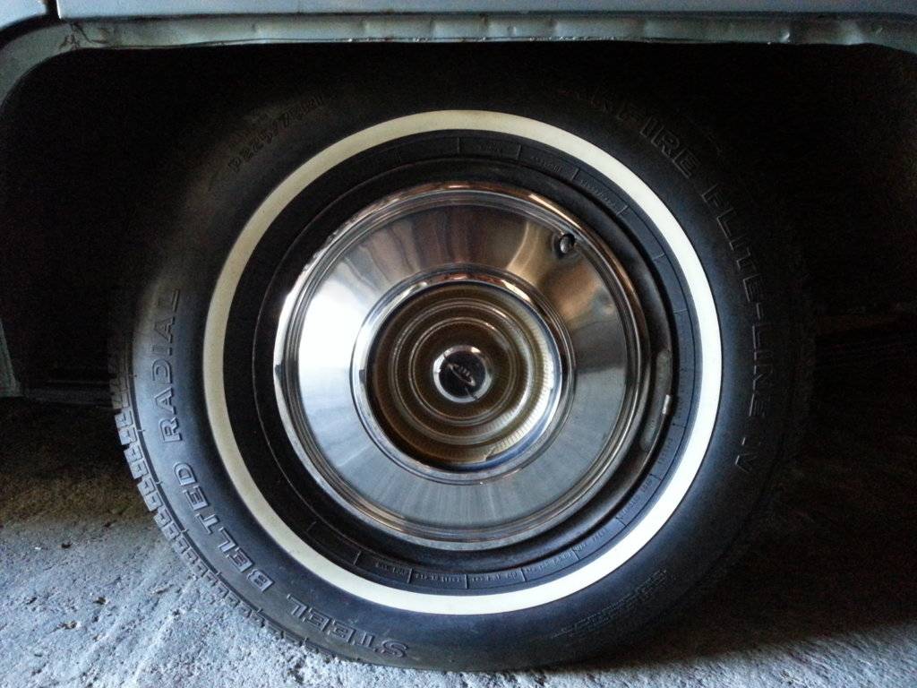

Regarding wheels - This was my dad's car that we've had in the family since '71. When I took it out of the garage after having been stored for 20 years it needed new tires. The front had H78/14 Bias-Ply's and the rears had new P225/75/14's. I liked the size of the H78's and thought the P225's looked too small for the car. Since the H78's were pretty much non existent or too costly if you could find them I upgraded to 15" wheels so I could get the similar size tires as the H78's. I also upgraded to 15" because I wanted to do the front disc conversion and needed 15" rims anyway to accommodate them.
The first photo attached is Blue's first sight of daylight after 20 years in storage.
The 2nd & 3rd photos are of the H78's and P225's and as you can see there was a Big difference! The main difference is the space between the rim lip and the white wall.
