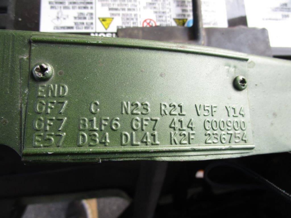

My B.S. is "H Series 1972" and Line 1 has the letter "C" in the U-C-I box that's part of the "Y Vehicle Del. and Handling Y" section. The letter "C" at the top and "CANADIAN SPEC." at the bottom would be two indications of final country destination.
Would the letter "C" on the third line of the tag be related to the "C" on the B.S.?
I'm familiar with the term VON, but not "modified VON".
Would the letter "C" on the third line of the tag be related to the "C" on the B.S.? Yes.
I'm familiar with the term VON, but not "modified VON". A typical '72 VON will start with a six digit number generated by the number on a standard order sheet. I'm using the term modified VON to indicate the car's destination (Canada or International) or purpose (Dealer Demo, Show car, Lease, etc) will be reflected by modifying the original VON and substituting the first number with a letter then five digits.
