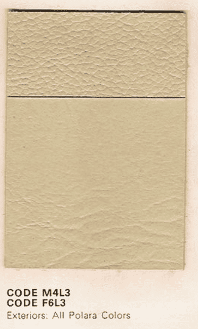

M4L3 - appears on both my build sheet under Trim Code and the Fender Tag. I believe it corresponds to vinyl bucket seats with center arm rest, which my car has. According to the sales brochure, it was offered in Parchment, which is the color of my interior. Is this correct?

Quick comment on the build sheet for DM43T2D240569: this is a lot of beige / tan (HL4 "Summer Sand" beige paint, V1T tan top, V5T tan rubber molding inserts, and M4L3 parchment interior)!
Is there a particular code you're interested in?
C54 - Speaking of interior, does this code correspond to the interior color? C54 = Split back bench seat/center console. This is the '4' in your M4 interior code.
