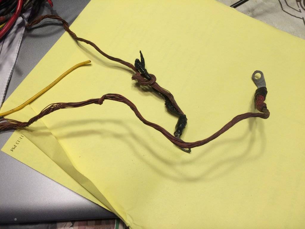

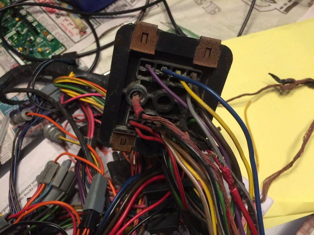

I got a pile of '65 Chrysler parts some time back that included a bunch of wiring harnesses. Every one of them has at least one burned wire in it. This one was pulling a lot of current through the ammeter before something failed completely or the battery was disconnected. Otherwise, the car probably would have burned up.
