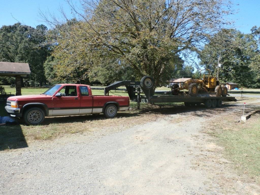

This trailer has electric brakes independent of each other with three separate brake controllers "and" power supplies on all three axles that can be locked up at 60. They can stop the Dakota whether it wants to stop or not. It tows the motor grader at 55 just fine.
Without that trailer the Dakota couldn't even tow and stop another Dakota on a tow dolly.
