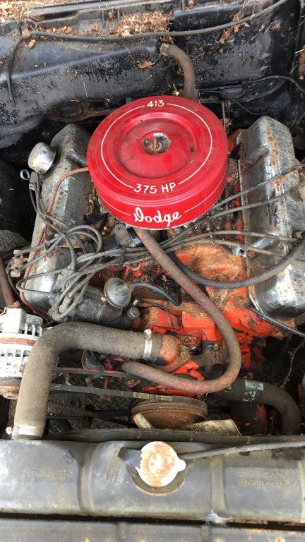

Mine has a P code that = 6, and I think that was the 413. I've haven't dug into if it still has a 413 though! Where is the block designation?
The Block id is right in front of the valley pan on top of the block stamped in. The flat spot right under the curvature of the heater hose.
