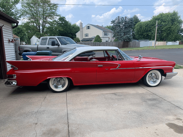

LOL - Well, I bought the car, so I guess I get to find out how much fun / frustration can be found in a 1961 Chrysler.
