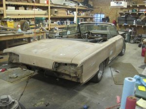

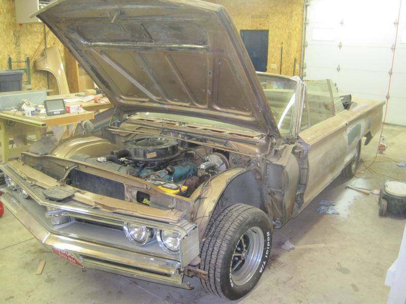

I got the car all blocked out and some of the minor body work finished, and started laying down putty. I found one spot on the driver’s door that some body work for a very small dent. Other than that repair, everything else was “repaired” with a rattle can of paint.
I was glad to find out that the rust in the quarter panels didn’t creep up further into the good steel, so the metal to be cut out will be fairly minimal.

nothing worse than opening up the outer metal and finding the inner metal toast.
(Sent using Forum Runner)
I am hoping to get it to my body man in two weeks to weld in the new metal, in the quarter panels and repair the bad dent in the crease of the passenger door. I am basicially on schedule if the weather will cooperate. I won't tow it on wet salty roads.
