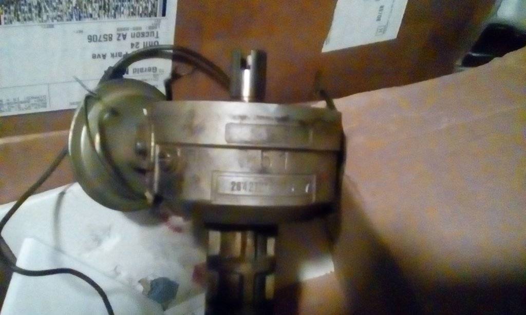

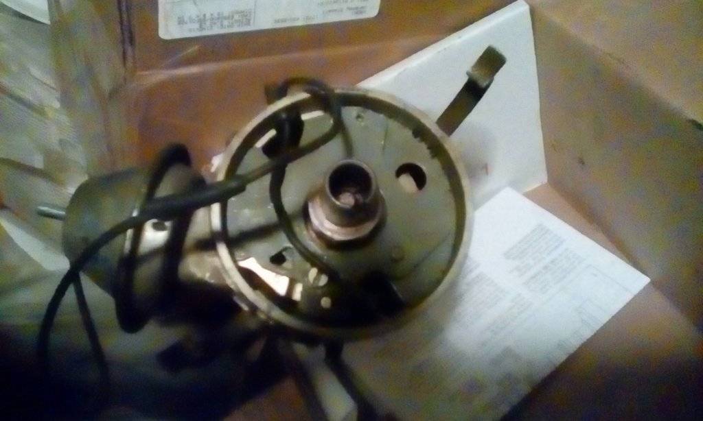

Post pics....
Here are 2 shots of the old # 2642727 dizzy. I can just nudge the rotor to the side w my thumb about .2 mm maybe. I see brass bushings fr Summit for about $3 on eBay. I'm sorely tempted to rebuild this one and have it ready. I suspect its full of hardened lube and crap, making it difficult to turn. Note how nice the breaker plate looks though! I hope this was what you were curious about. The reman looks OK, but....
I was hoping for when you rebuild it.
I'll happily do that too! Ergo, Ante & Post Rebuild pics. I think outlay for rebuild parts is going to stay <= $10 for a bushing. I read a nice How2 here: How to Rebuild and Reinstall Car Distributors
I likely have to redo the vacuum advance bellows too, so whatever that runs for will add in. From this point on: the rest of the outlay is in terms of headache and elbow grease. Should make a nice little bench project this winter!
