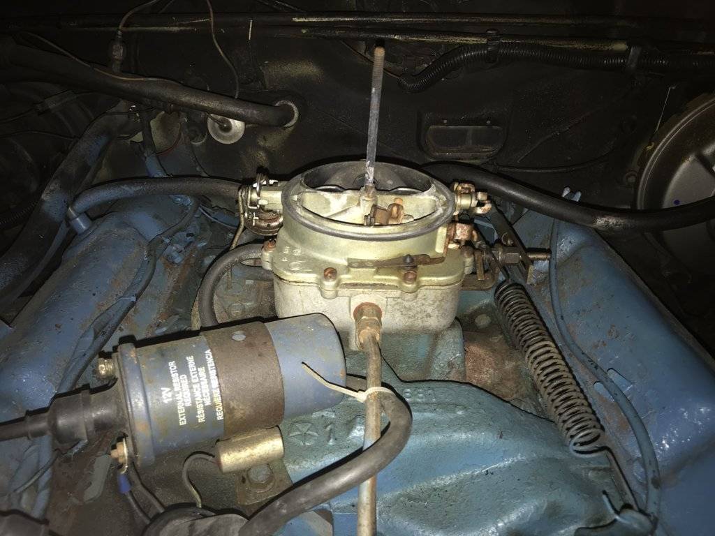

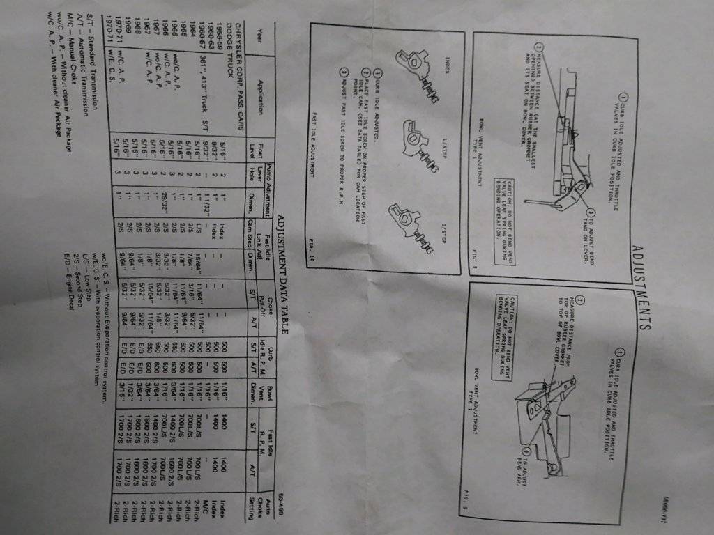

i have the same bbd 2 bbl carb on my 68 newport ... i rebuild it using napa kit... see pics
