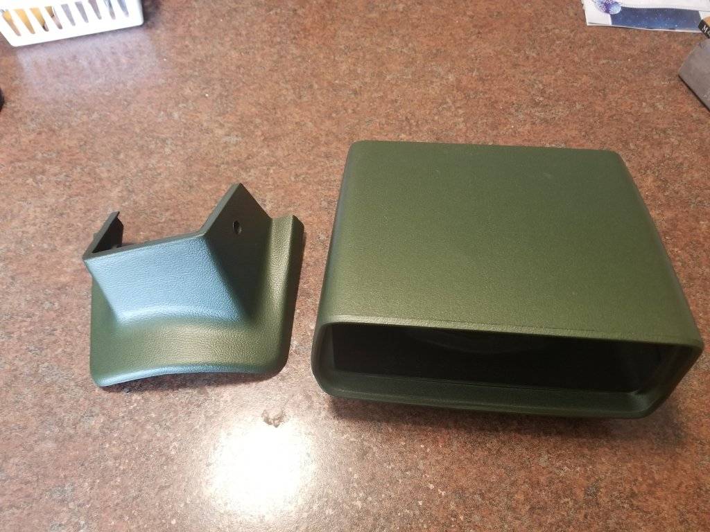

BTW the case should be the same color as the interior plastic. If its black, it's a replacement unit. (Unless the interior is black.) I assume quite a few were stolen back then.

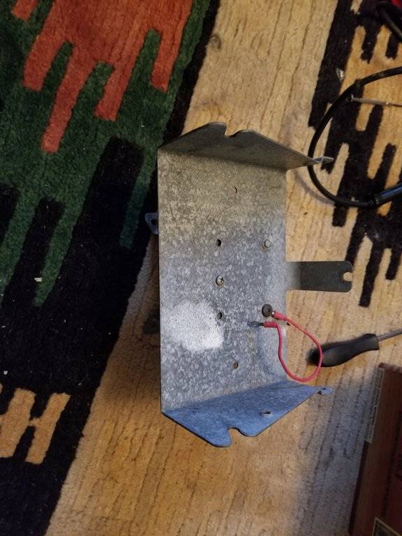

Looking for the rest of the cassette parts. Still looking for the metal base. The long cord went under the carpet and attached to the player and radio.

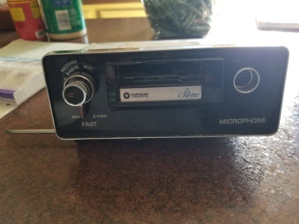

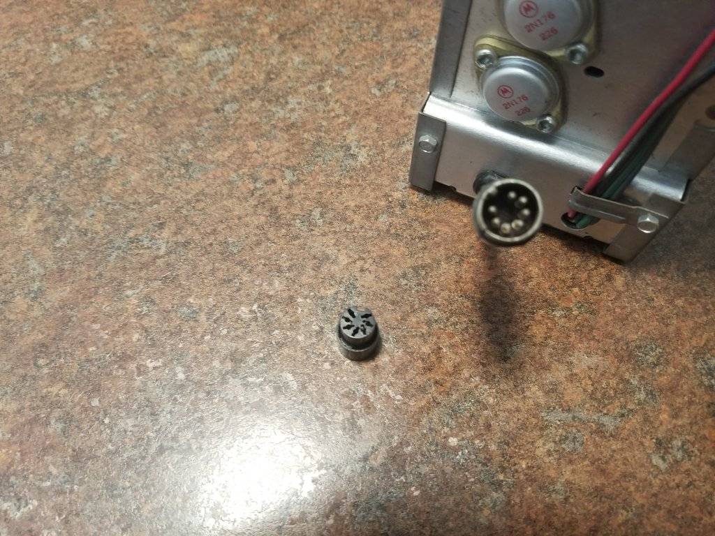

To test the unit it must be attached to a radio. I purchased this spare many yrs ago for $20. Off ebay. Prices have gone up. Notice the plug for the cassette attachment. Apparently this plug is used when no cassette was ordered. The two small boxes (only one needed) are for stereo.
The reason I asked if it's for a fury is because of the faceplate which is different from the one for the New Yorker. See pics. Radios are the same.

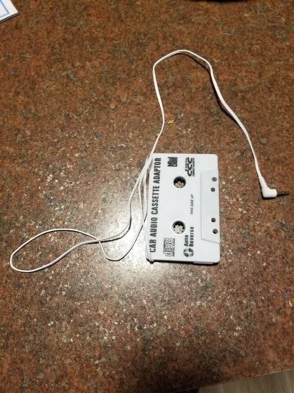

The reason I want the cassette player to work is because I want to use my android phone with it. I have two other cars with cassette players and use the following with my phone. Found this at a good will store for around $2. seen others on ebay for $10. It only works with an android. I Phones have a different connector.
I dont think the cassette player belts will matter when using the android.
They call this the shorting plug - it closes the output circuit.

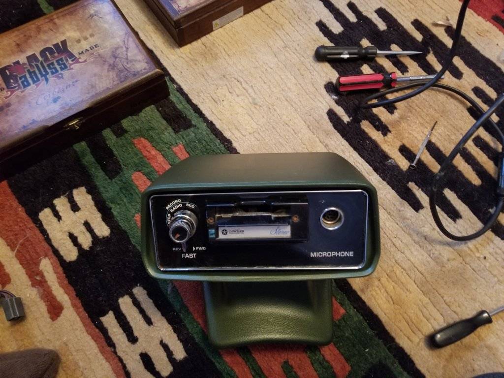

Hooked the cassette player up to a radio and speakers. Using my cell phone and the above reference adapter. It worked. Will start the search for belts. Will try cassette tape next, if I can find one.
