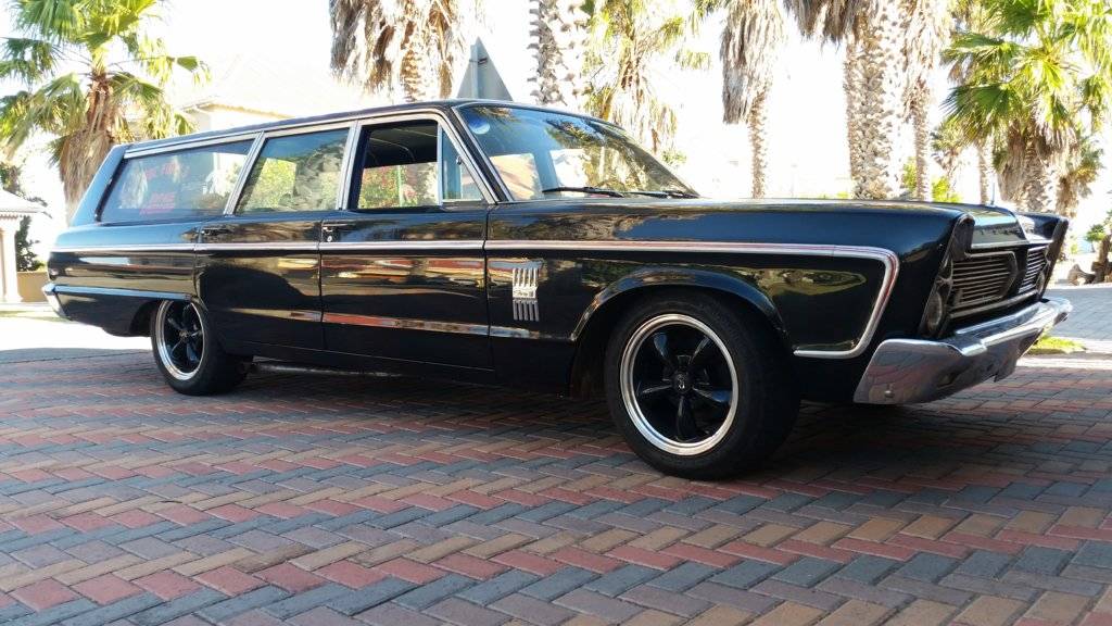

I have a 318 3 speed '66 Fury 111 I use nearly daily here in South Africa
Due to contractures in my hands I am thinking of changing to auto, to make driving easier.
I have aquired a complete auto steering colum from a '66 New Yorker and a 727 box.
Can anybody tell me if this is a doable modification?
1. I realise I'll have to change the propshaft, make it shorter?
2. Do I need a different cross member etc for auto
3. Will the '66 NY colum fit in the Fury without major modifications ?
4. Linkages from the colum to auto box obtainable or can one make them?
Sorry for 'stupid' questions, but I have the only wagon in SA and parts/help is very scarce here.
I appreciate any input and advice, before I take this on. I have a mechanical friend that will help me.
Thanks, Roel
