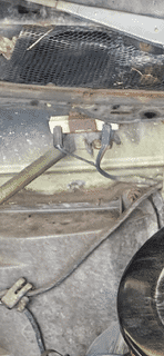

Had an issue like this. Starter would crank but car would not start. Went to this forum and someone said to replace the ballast resister. Did this and the car fired right up. Took longer to find the ballast tester than it did to replace it.

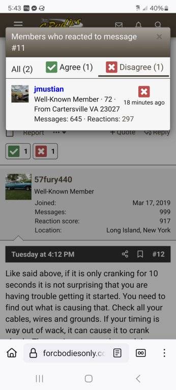

Read the OP's first post. With a new battery and starter, it only cranks for 10 seconds. Not long enough to get it started. He has issues he needs to address first before he messes with the timing or carburetor.
@jmustian you disagree?
